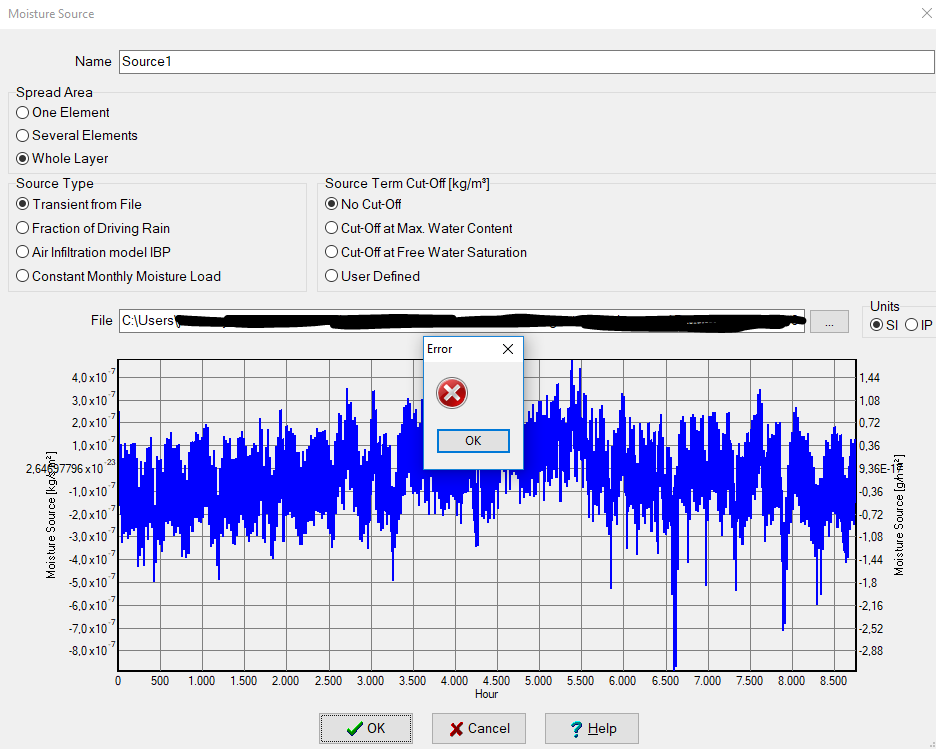

When I add a moisture source from a transient txt file I get an error when I click on the OK button (see printscreen).
WUFI version 1D 5.3
regards,
Jonas
Error when adding source from transient txt file
- Error WUFI.PNG (60.96 KiB) Viewed 66962 times

Re: Error when adding source from transient txt file
Dear Jonas,
both files work for me. What version of WUFI Pro do you use? The latest is WUFI Pro 5.3.4.
Hello Christian,
I have version 5.3.3.1353.
I have also problems with moisture sinks with a monthly negative value. When I try to type the yearly moisture load, the program removes the '-'sign.
regards,
Jonas
regards,
Jonas
Dear Jonas,
can you please update to the latest version of WUFI Pro 5 using the download link you got with your WUFI purchase?
The monthly constant source does not work with negative values. That can only be used as a source, not as sink.
