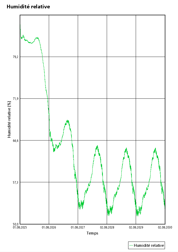

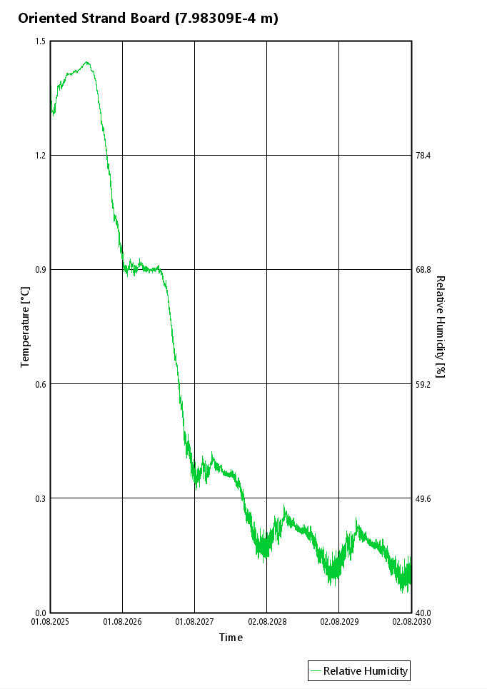

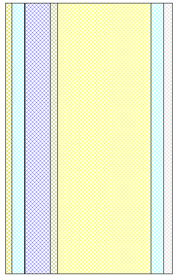

For example, within my envelope model, the studied surface is in contact with the OSB layer. Despite replicating the same mesh (by transferring values from WUFI Pro) and using identical calculation parameters (Maxit = 600, convergence criterion = 1e-6, URF matching WUFI Pro, and NSW = 1000) as well as identical materials and settings, I am unable to achieve the same relative humidity or overall water content in WUFI Pro and WUFI 2D.
When placing an observation point in WUFI Pro within the OSB layer and comparing it to the same location in WUFI 2D, the results differ. I am unsure of the cause of this discrepancy. Please see the attached figures for reference:
My issue regarding the exterior material has been resolved. However, I am still encountering difficulties in obtaining consistent relative humidity and water content values within my materials.

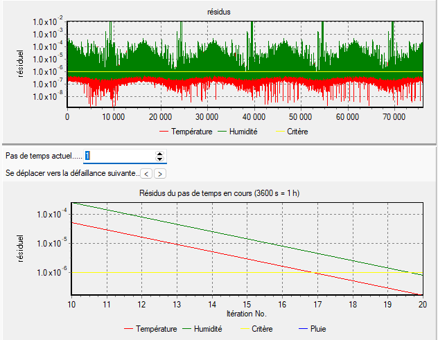

Convergence criterion not reached 9 times
iteration interrupted 56 times

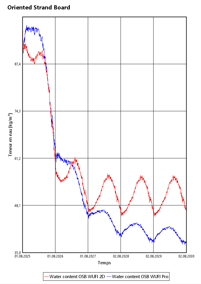

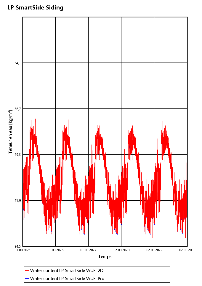

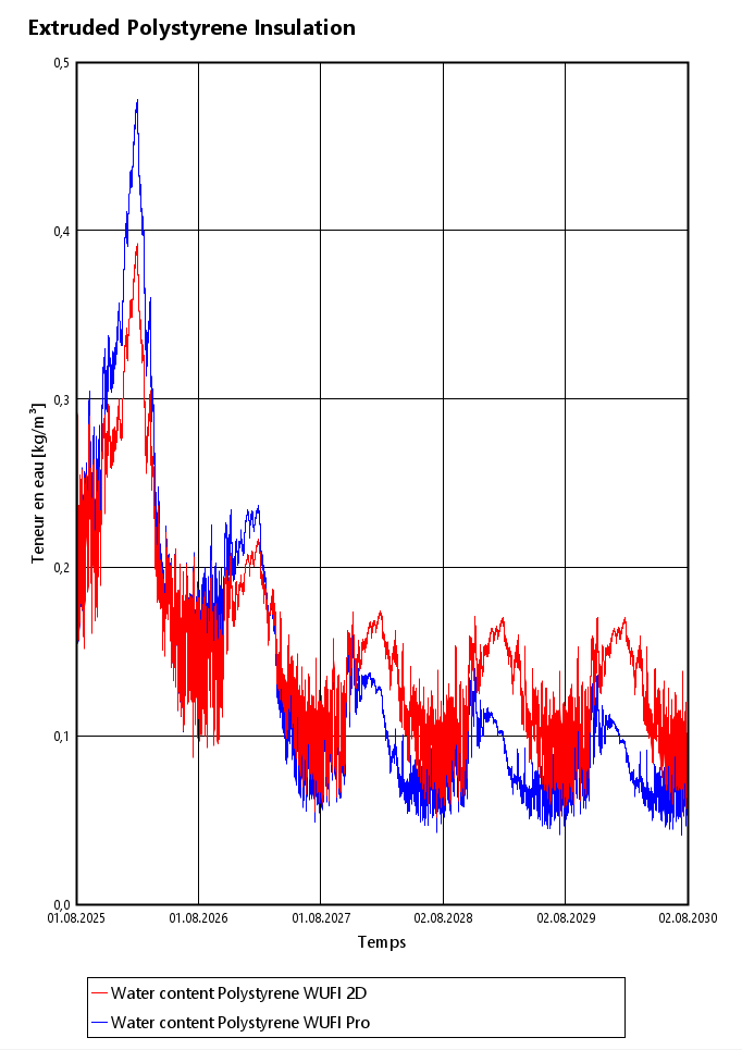

Please find below the direct comparisons from WUFI Graph for the water content in 3 different layers. Despite identical material properties and identical horizontal grid layouts, the deviations remain noticeable (especially for the OSB layer, which later causes a significant difference in the Mould Index when analyzed with WUFI Bio).
Water Content results WUFI Pro/ WUFI 2D:

The fact that WUFI Pro runs without any convergence failures while WUFI 2D still reports convergence and iteration issues suggests that numerical effects may still be influencing the results. Therefore, I would first focus on verifying the boundary conditions and simplifying the assembly as much as possible before drawing conclusions from the differences in water content and mould index predictions.

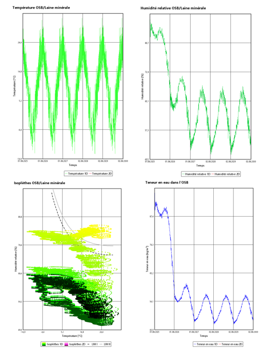

Thank you for your help. I finally managed to get the same result, and the key was to analyze both results in the WUFI graph in order to identify where the observers are located in WUFI Pro. This allowed me to easily see where to analyze my WUFI 2D envelope and obtain results from exactly the same location as in WUFI Pro. This requires having the exact same mesh in both models.
So, in conclusion, I was not comparing the exact same locations in both models.
However, I am convinced that all the parameters we adjusted previously were relevant and helped achieve matching results.
One thing that helped me was going back to a very simple envelope before gradually increasing its complexity.
Thank you.
Cyprien
Thank you.
Cyprien
