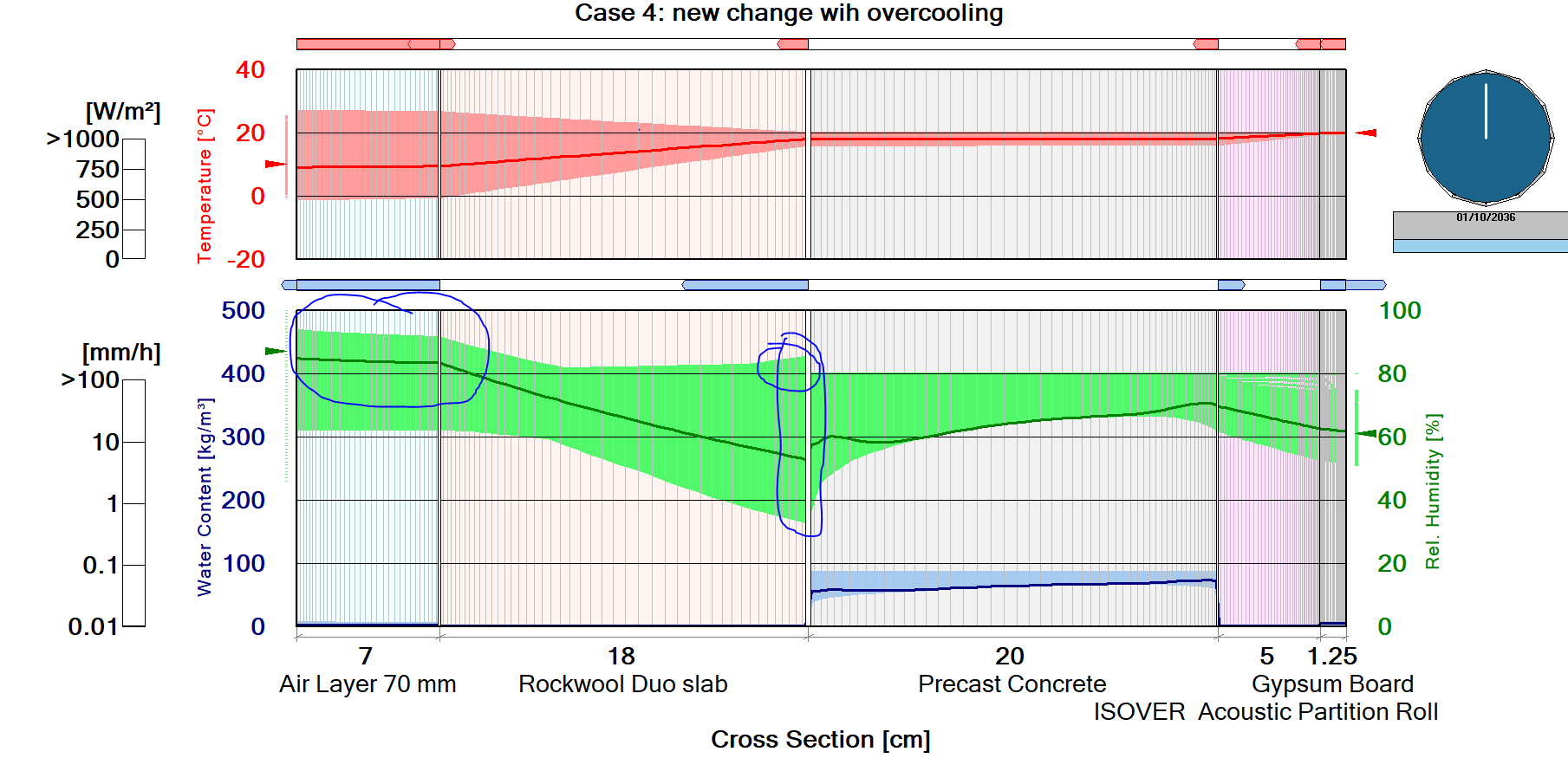

1- If I follow the guideline on “Assessing the Risk of Interstitial Condensation Runoff,” what minimum RC value should I consider? I ask because I do not have a water- and vapour-tight surface in my assembly, and I do not consider it would be appropriate to consider the concrete layer as one (correct me if I am wrong, I have seen projects that concrete layer is used as a airtightness layer reaching lower ach in blower door test with this strategy).
2- Also, if there is no risk of interstitial condensation runoff, does that necessarily mean that the assembly will not experience moisture-related issues, even if the RH in the unventilated air cavity and at the outer side of the insulation remains above 80%, as shown in the image?

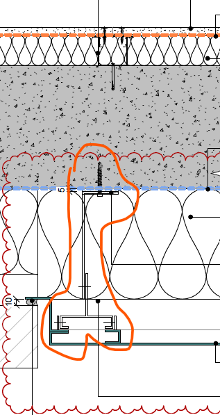

3- One other point I am concerned about is the area I have highlighted in the image. The aluminum carrier rails have a protective oxide layer, but can corrosion still occur under certain environmental conditions, particularly if the RH remains high for extended periods as showed in the WUFI film? Can interstitial condensation in the outer part of the external insulation to move inwards through this aluminum carrier rails? as If yes, how to prevent it as I do not have any breather membrane.

In your case, I would be cautious about using the "50 g/m² without adjacent insulation" limit.1- If I follow the guideline on “Assessing the Risk of Interstitial Condensation Runoff,” what minimum RC value should I consider? I ask because I do not have a water- and vapour-tight surface in my assembly, and I do not consider it would be appropriate to consider the concrete layer as one (correct me if I am wrong, I have seen projects that concrete layer is used as a airtightness layer reaching lower ach in blower door test with this strategy).
The runoff guideline was developed primarily for condensation occurring on water- and vapour-tight surfaces such as membranes, vapour retarders, metal sheets, etc., where liquid water can collect and run off.
If condensation is predicted at the interface between the foil facing of the PIR and the cavity, then the foil facer itself behaves as a water- and vapour-tight surface. The concrete behind the cavity would not normally be the relevant surface for the runoff assessment, even though concrete can act as an airtight layer in practice.
Therefore, I would evaluate the condensate amount at the foil facer surface. For a smooth foil surface, the base value would generally be the minimum retention capacity without any surface surcharge. The inclination-related surcharge can then be added according to the guideline if applicable
The runoff assessment only answers the question:2- Also, if there is no risk of interstitial condensation runoff, does that necessarily mean that the assembly will not experience moisture-related issues, even if the RH in the unventilated air cavity and at the outer side of the insulation remains above 80%, as shown in the image?
Is enough condensate forming at an interface that liquid water can run down or drip?
It does not assess:
- mould growth risk,
- corrosion risk,
- long-term high humidity,
- elevated equilibrium moisture contents,
- thermal performance reduction,
- durability of adjacent materials.
For example:
- 85-95% RH for extended periods may be problematic for some materials.
- Metallic components may be exposed to increased corrosion risk.
- Organic contaminants or dust deposits may support mould growth if suitable substrates are present.
Pure aluminium is generally highly resistant to corrosion because of its naturally occurring oxide layer.3- One other point I am concerned about is the area I have highlighted in the image. The aluminum carrier rails have a protective oxide layer, but can corrosion still occur under certain environmental conditions, particularly if the RH remains high for extended periods as showed in the WUFI film? Can interstitial condensation in the outer part of the external insulation to move inwards through this aluminum carrier rails? as If yes, how to prevent it as I do not have any breather membrane.
However, corrosion can still occur under certain conditions, for example:
- persistent surface wetting,
- trapped moisture in joints,
- chloride contamination,
- galvanic contact with dissimilar metals,
- crevice conditions with limited drying.

Yes, aluminium rails can locally act as thermal bridges. Their lower temperature may increase the likelihood of local condensation compared with the surrounding insulation.
However, WUFI 1D cannot realistically represent:
- drainage along rails,
- moisture migration along the rail profile,
- local condensate accumulation at connections.
The condensation occurring in the outer insulation does not simply "move inward through the aluminium" by diffusion. The more likely mechanism would be local surface condensation on cooler metal components.
