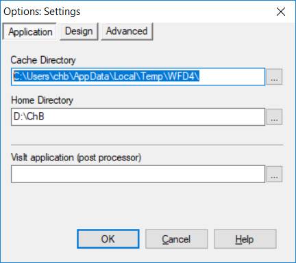

There is a way to do this manually. Before closing WUFI, go to the cache directory and copy all files into your project directory.
The path of the cache directory can be found here in the Options -> Settings dialogue
Settings dialog
Settings dialog
