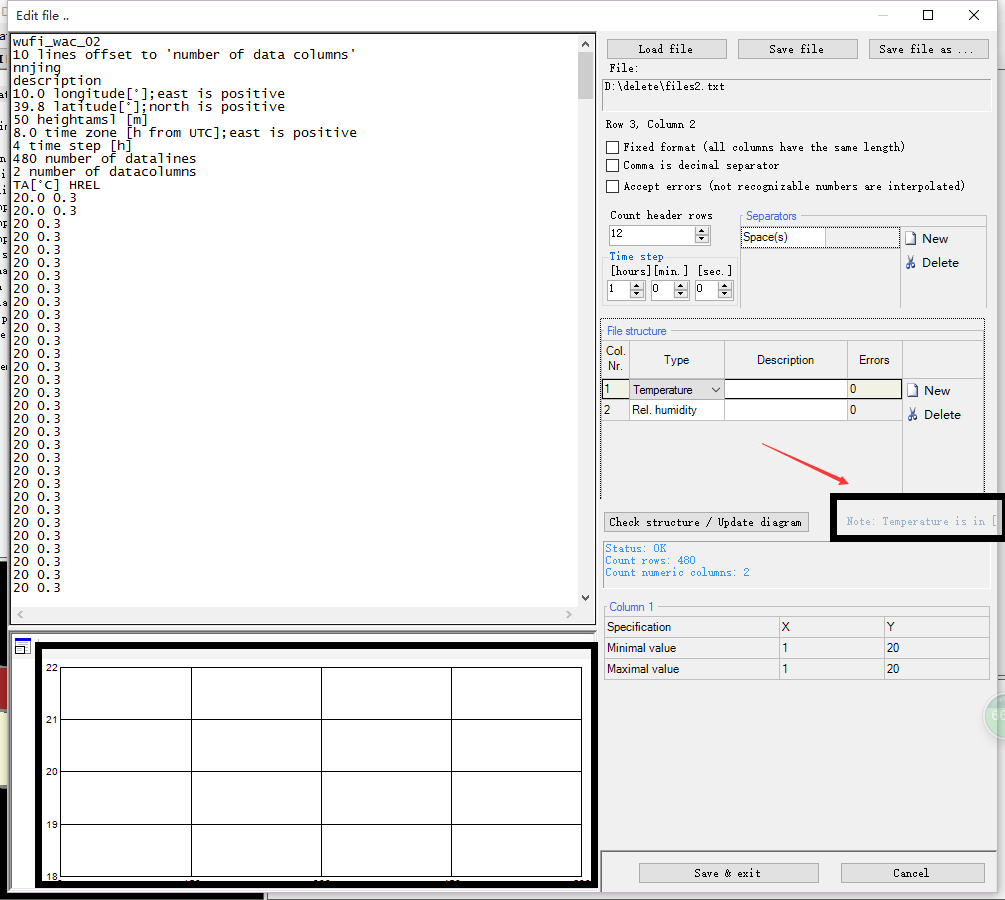

1, when i manually input the data in the blank, the temp column have some error showing in the status tips.but i can't wholely read the tips .

1. ok, the marked note is to long for your windows-default-font. It just says: " Note: Temperature is in [°C]" in degree Celcius. This is not an error. the box below is relevant for errors and it says: Status: Ok. so everything seams to be fine. your file has only one themperature. 20°C, so the graph isn't drawn perfect, behind the grid in the graph. But if you have an look at the minimal, maximal value, both is 20°C (in the y-axis).
