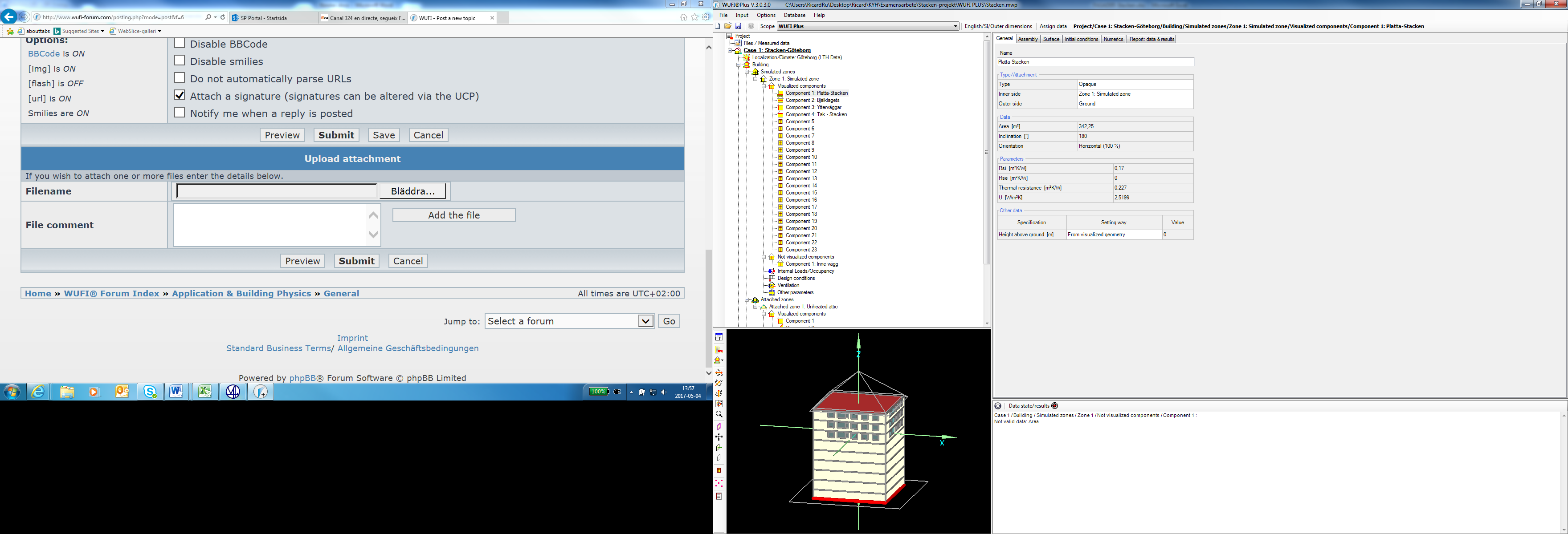

I have some problems with the project in WUFI plus. I'm close to finish but I have a problem with the Area. I can't find where I should change the value. You can see the error in the attach document.
- area.png (360.59 KiB) Viewed 7685 times

If there is a missing or out of range parameter input, the message is shown.
If you left-mouse double click on the message, it jumps to the form, where the input is missing.
In your case, it seams that there is no surface area defined for the not visualized component. For those components, not defined in the 3D visualization, this surface area can't be calculated by WUFI Plus.
