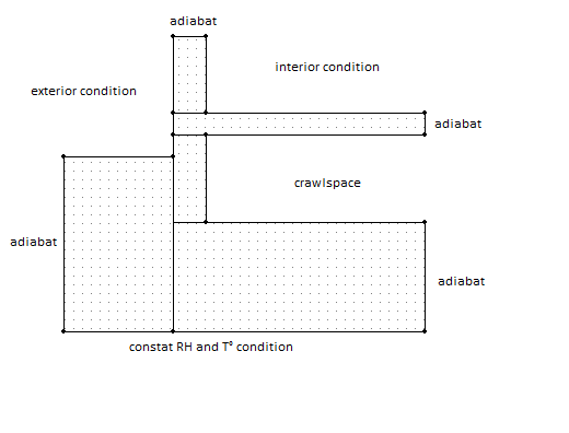

I would like to know if in your mind, Wufi 2d can be used to do a serie of simulations in order to finally find some values of interieur boundary condition.
I explain : i'm gonna have to study some slab system (with differents layers of materials) above crawl space.
I have exterior climatic conditions with my own file and the interior boundary conditions above the slab. However i don't have the hygrothermal behavior of crawl space on a entire year.
I have for the moment 2 ideas :
-Consider the space of the crawl space as a "air blade" in materials library and examine the relative humidity and temperature of this material after the processing. Though i cannot add an air exchange source in the crawl space with this way and i'm not sure the processing would correctly execute.
-Consider in a first time some approximate boundary conditions from the litterature and do some simulation in order to assess the difference of T° and RH in the crawl space, and repeat this operation until the stabilisation of the results. But i don't think Wufi gives the interior condition after simulation, isn't it ?
Here is a arbitrary modelisation to explain myself :
Photo forum wufi.png (5.61 KiB) Viewed 91228 times
Many thanks!

Hi PierreC,
WUFI 2D is not quite suitable to simulate the climatic conditions in the crawlspace, but you can use WUFI Plus (https://wufi.de/en/software/wufi-plus/) to do exactly this. What kind of assessments do you want to perform in detail? Do you need to do a 2D hygrothermal simulation?

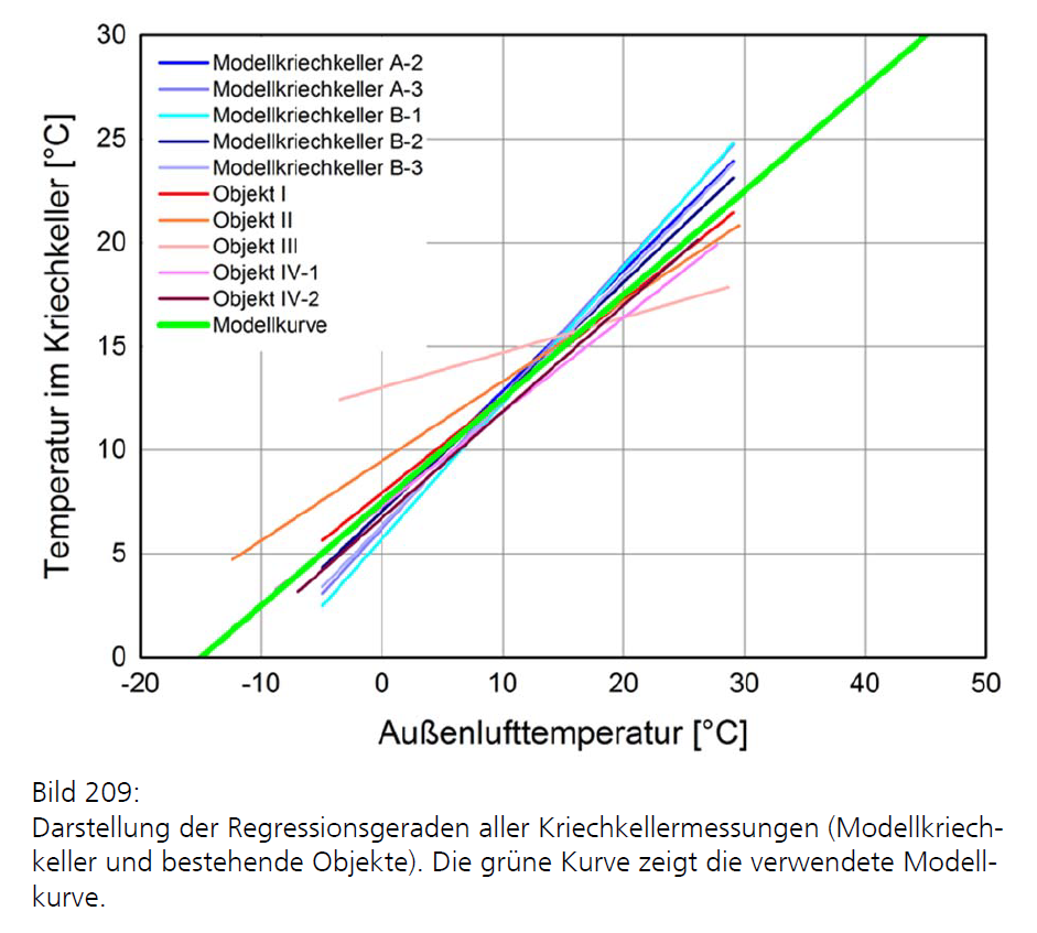

The temperature is derived according to the green regression line:
Temperature in crawlspace derived from outdoor temperature.
The x-axis is showing the outdoor temperature in [°C]
The y-axis is showing the temperature in the crawlspace in [°C]

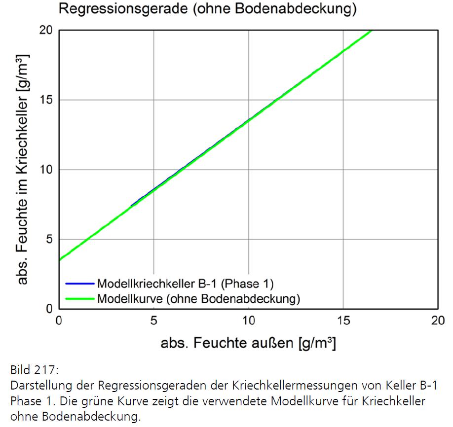

For uncovered crawlspace floors the absolute humidity inside is related to the absolute humidity outside as follows (green line):
Absolute humidity in crawlspace derived from absolute humidity outside for uncovered crawlspace floors
The x-axis shows the absolute humidity outside in [g/m³]
The y-axis shows the absolute humidity in the crawlspace in [g/m³]

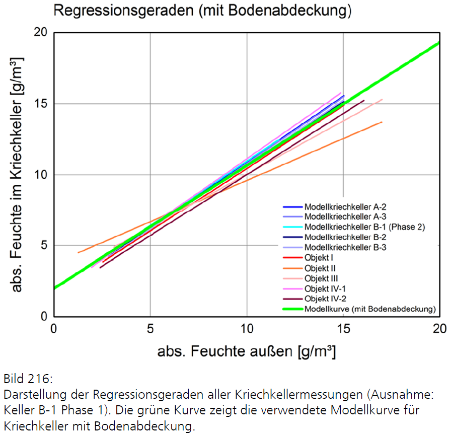

For crawlspaces with covered floors the absolute humidity inside is related to the absolute humidity outside as follows (green line):
Absolute humidity in crawlspace derived from absolute humidity outside for covered crawlspace floors

  1. Calculate the crawlspace temperature from the outdoor temperature according to pic 1.

  3. Add the humidity supplement according to pic 2 or 3

what do you mean with "humidity supplement"?
You have to set the absolute humidity indoor for each hour corresponding to the humidity outside as shown in pic 2 or 3.
So for pic 2: If your absH outdoor is 0, set the indoor to 4, if it is 10, set the indoor to 12.

1-Calculate the crawlspace temperature from the outdoor temperature according to pic 1
but the crawlspace temperature (y-axis) is unknown.
I missed something,
Nope, the crawlspace temperature is derived from the first picture. Picture 1 shows which temperature your crawlspace has at which outdoor temperature. So open your climate file in excel or some other program and for each hour derive a crawlspace temperature from the outdoor temperature according to pic 1.
For example if your climate file shows an air temperature of 25°C, the temperature in your crawlspace is at 20°C.

Posted: Wed Jun 01, 2022 11:17 pm -1100
Dear Alberto,
the three pics ARE the model we created. They show the relation between outdoor climate and indoor climate measured for different objects (colored lines) and the regression line we derived from the measurements is the green line.
So you just have to transfer your outdoor climate into a crawlspace climate using the green lines, as it is described step by step below the three pics above:
viewtopic.php?p=5878#p5849
