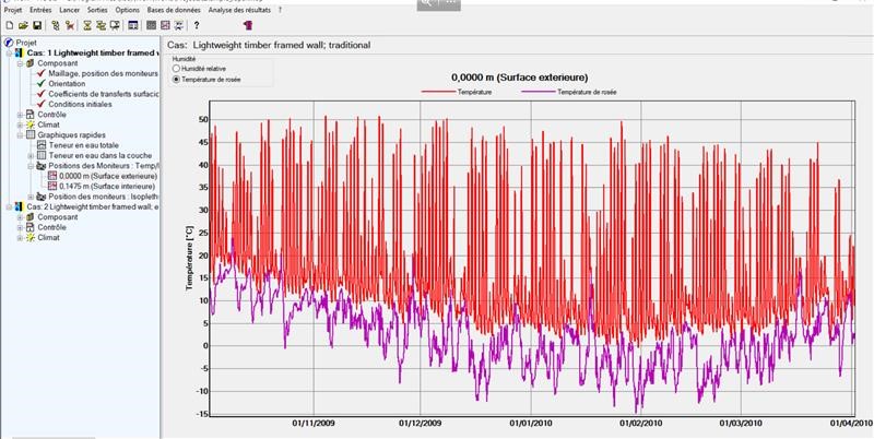

This is exactly what I observed on several models with both WUFI 5 and 2D: surface temperatures reach ~60-70°C while outdoor air temperature is around 10°C and short wave radiation is around some hundreds of W.m-2 (France winter conditions). I of course checked my model and my weather file and everything looks fine.
My opinion is : this latent heat flow is neglected and, as long as the solar heat gains prevail on the other terms of the boundary heat balance equation, the temperature is overestimated. Does someone confirm this ? Did I missed something ?

- TemporalSeries_2___1D_MUR_ITE_BARD_BP_LDB_Temperature.png (45.89 KiB) Viewed 71694 times

If the surface temperatures computed by WUFI were always grossly wrong, this would certainly have been noticed long ago. Most likely, there will be some problem with the input data. Maybe the entered solar absorptivity is too high? Maybe the heat transfer coefficient is too low, leading to an accumulation of heat? Maybe the text field for the heat transfer coefficient is set to "resistance" instead of "coefficient"? Maybe the inclination of the component is wrong, so that the calculation is done for a flat roof instead of a wall?

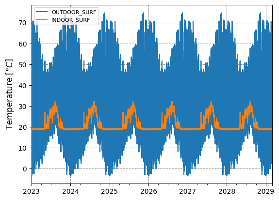

We checked again our model, and everything looks right. Just to be sure the problem does not come from our own weather file, we used instead one available from the map (We chose Bordeaux, France). And we still obtain temperature above 50°C in winter (less in summer since our wall is vertical and oriented south), which seems quite unrealistic.
We also tried to run one of the example files (C:\Program Files (x86)\WUFI\WUFI5\Projects\ Example_Japan.w5p) modifying only the orientation of the wall (we set south instead of north). This model also yields surface temperature around 50°C as can be seen below.

Yes, but the surface of the Japanese component has a solar absorptivity of 0.8 - almost black. With the solar radiation often reaching substantial intensities between 500 and 750 W/m², relatively high short-lived peak temperatures don't necessarily seem implausible to me. If you reduce the absorptivity to 0.4 (a "broken white", more representative for typical facade absorptivities), the temperatures only occasionally exceed 40 °C.We also tried to run one of the example files (C:\Program Files (x86)\WUFI\WUFI5\Projects\ Example_Japan.w5p) modifying only the orientation of the wall (we set south instead of north). This model also yields surface temperature around 50°C as can be seen below.
