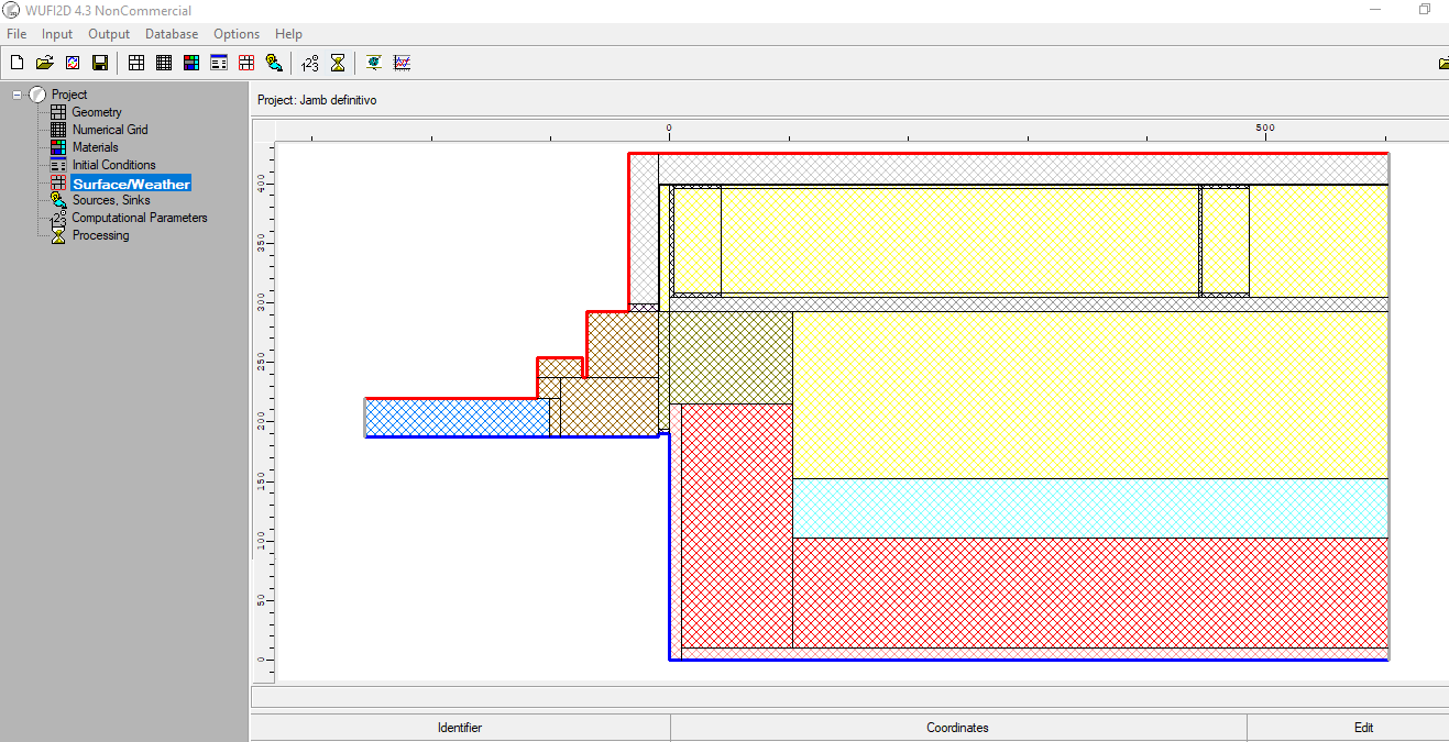

the Wufi 2D file attached shows a jamb detail. I have a few questions:
1- where should the 1% rain be placed? see image please
2- how should I model the air infiltration from indoors? where should I placed it? see image
3- if you enter 1% rain then, do we need to calculate the strength of that source or WUFI does it automatically for each grid element? does Wufi transform L/m h from climate file to kg/m s to each grid element? how does wufi distribute that 1% rain individually between all grid elements selected in the interface of WUFI 2D (tab sources/sinks)? if we have 3 different exterior boundary due to the different characteristic/properties of the external surface, which one should we associated to the "fraction of rain Load"?

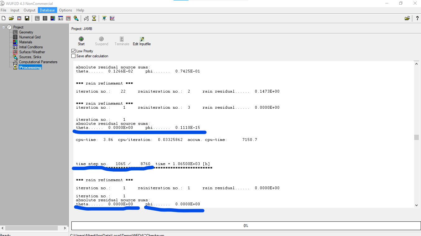

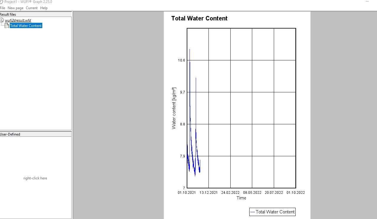

mes y medio 2.png (42.02 KiB) Viewed 143311 times
As you can see my simulation stops after one monh and a half when theta and phi starts being zero. I have been reading all post about this issue in WUFI 2d and I follow all of them changing convergence criteria, changing NSW, simplyfy the model, etc etc, I also change the material but, what is the sense of doing that if you real material are other? how can you extrapolate the results?

according to your questions:
1) in my eyes there is no special need to place a rain source in there or or are you concerned that water may run in next to the window connection?
2) why would you model an air infiltration here. This should be build air tight.
3) you do not have to calculate anything. WUFI is taking 1% of the rain which is available in your boundary condition, already related to the orientation and is spreading that on the area you define.
4) I do not completely understand the question. The fraction of 1% is from the ASHREA Standard 160. The rain is usually measured as rain on a horizontal surface measured in liter or kg per m² and hour. With that, the orientation and the rain WUFI calculates the rainload for the surface:

5) It is often not clearly pointable, what causes an convergence problem. Can be a material, climate condition, etc. I would recommend to simplify your construction especially for the window and frame. I would replace them by a single material with effective values for vapor diffusion and thermal conductivity instead of building them from eg. glass and air. Further check in the WUFI2DMotion, if there is a peak in water content at the moment before the calculation stops. If so, try to change the material at this position.
Last I recommend to switch on the adaptive time step control in the computational parameters as well as in the enhanced settings try, if it helps to switch on the rational interpolation of the sorption isotherm.

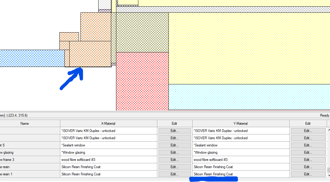

apologise, i though it was the right file. it should be a silicone resin coat
please see the new file
coat resin.png (36.28 KiB) Viewed 143293 times

yes, thats correct this way, but I would use a sd-value in the boundary condition instead of building it in as a layer, as that calculates much faster. If you do so, switch off the rain for this surface, as the sd-value does only affect the RH and not the rain.

These peaks in your water content are not convergence errors. They are related to rain events. The aerated clay bricks have quite a high a-value, so they are sucking up the rain water quite fast. In the total water content that shows an high influence. Have a look on the water content of the wooden frame for example, there are no peaks. Or compare with a calculation without rain, that should not show these peaks.

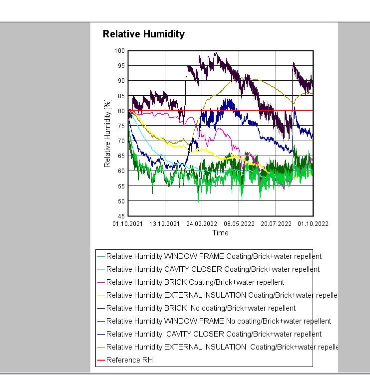

what I observe from the results is that the moisture absorbed in the window frame is transmited to surrounding areas but what I do not understand why is the Relative Humidity BRICK Coating/Brick+water repellent model is different to Relative Humidity BRICK no Coating/Brick+water repellent (i mean coating in the window frame is the difference between both models),
do oyu know why?
another thing i the peaks/jumps observed in Relative Humidity BRICK no Coating/Brick+water repellent and Relative Humidity CAVITY CLOSER no Coating/Brick+water repellent- and Relative Humidity EXTERNAL INSULATION No coating/Brick+water repellent
do you know why?

can you please show me, what positions / areas you are using in detail for evaluation?
