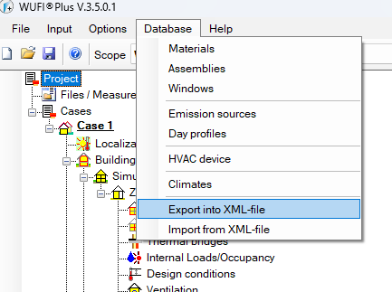

1. How can I transfer my user defined database that I have on my desktop computer to my new laptop?
2. Any guidance on how to keep these user defined databases in sync? I work from my laptop as well as from my desktop.
Thank-you in advanced!
Posts: 202
Re: Transfer of user created database to new computer
Post by mpazold »
The recommended way is to export the user defined data into an xml file and import this xml file it on the other/new pc.
In the top menue:
export database.png (23.41 KiB) Viewed 57990 times

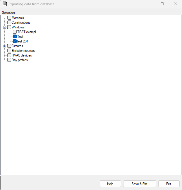

with that select the data to be exported / imported:
select data to export import.png (14.86 KiB) Viewed 57990 times
i also recommend to do this, before uninstall/drop WUFI Plus/Passive on the old pc.
Another way is to copy the database file/folder in the hidden folder: C:\ProgramData\WUFI\Database .
