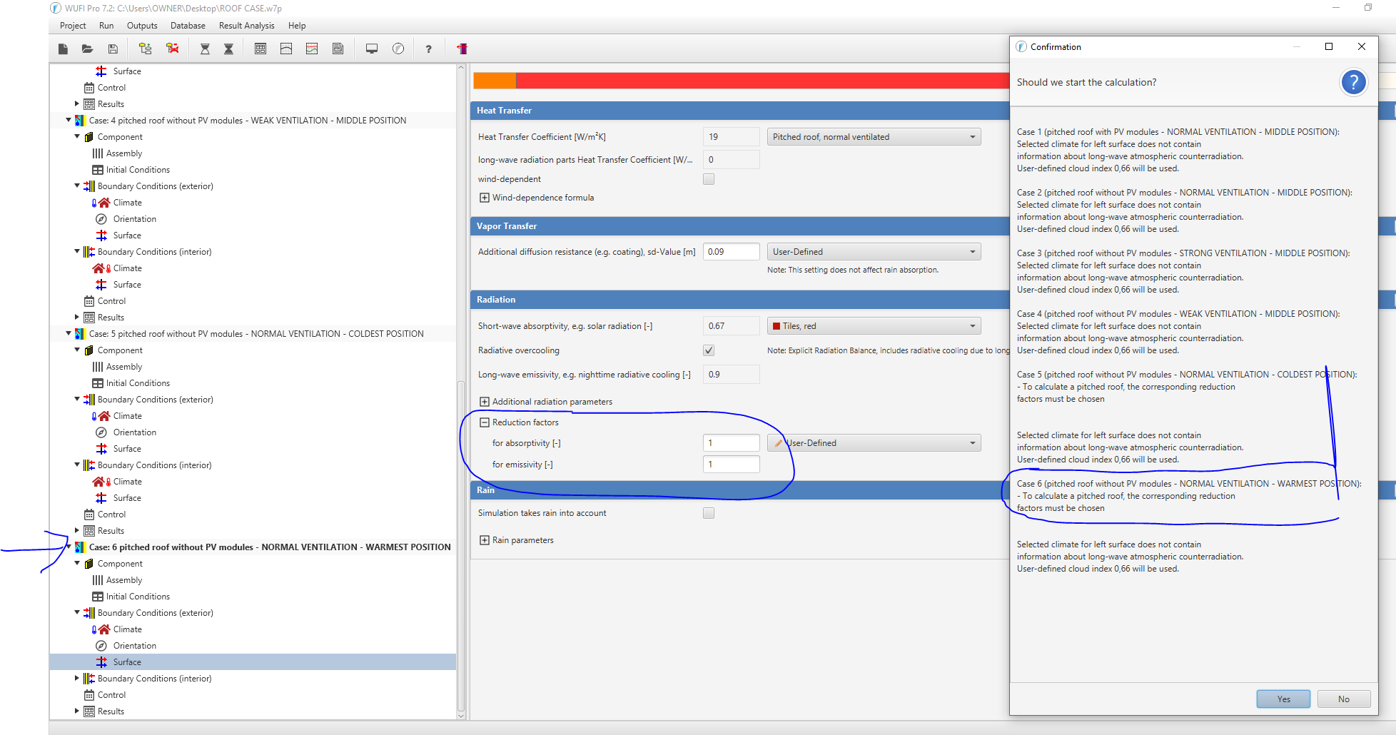

I got a message about parameters that I have defined previously but, the software detects as an error...so my concern is if the results will not be accurate...
in terms of ach, what is the range of ach for a pitched roof with strong, normal and low ventilation?

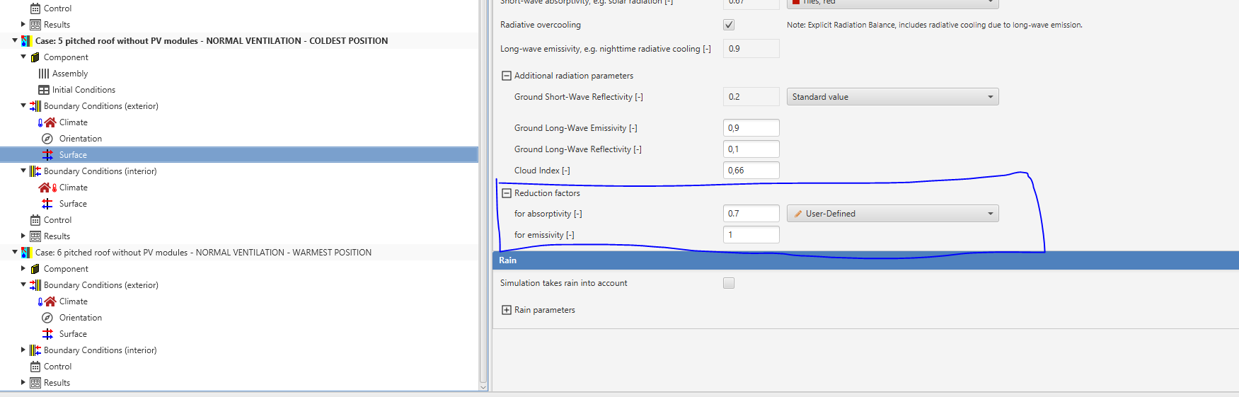

Thanks for you reply. i have followed that guidance.
Could you add a screenshot where to find that ""Reduction Factors" drop-down menu" as I select User-defined?

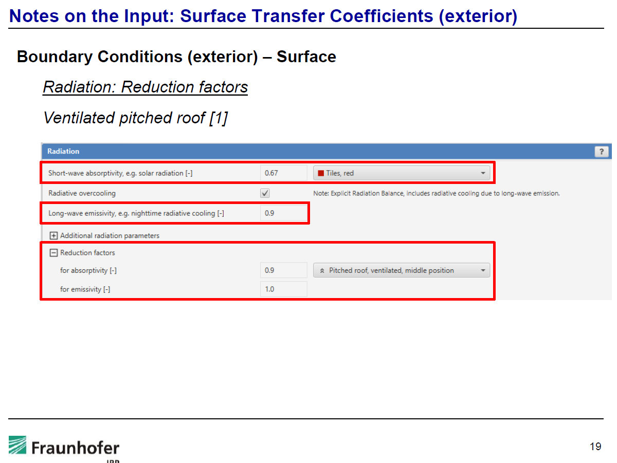

the warning simply indicates that the settings do not follow the recommended configuration described in the guideline. If you have a specific reason for using different reduction factors, the warning can generally be ignored.
The recommended settings for the reduction factors are illustrated in the Pitched Roof guideline on page 19:
Pitched Roof Settings

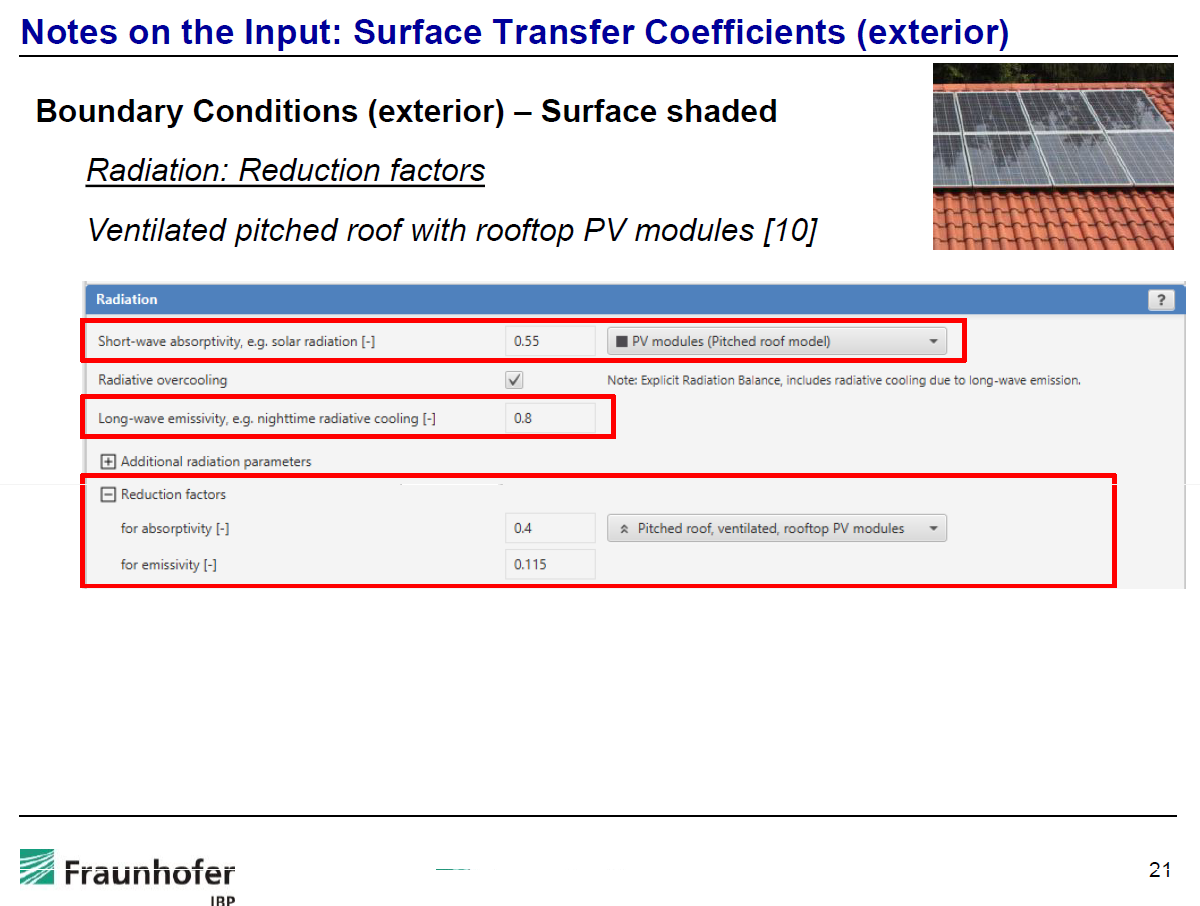

The settings for PV-modules would be on page 21:

thanks but the error is showed when I define the reduction factor for the coldest and warmest position of a ventilaed roo so, I add user defined reduction factors

it is a warning, not an error.
If you have a specific reason for setting these reduction factors, the warning can generally be ignored.
Only the center position is included in the surface calculation, which is why this warning is displayed. If you are using different positions, you can safely ignore the warning.
