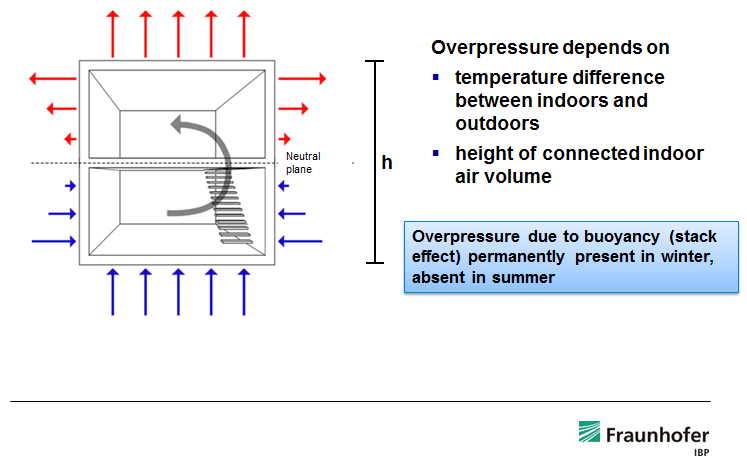

In the Air Infiltration IBP model dialogue, is the "stack height" the height of the building, or the height to the neutral plane?
Re: Air Leakage Assumption
Hi Axelarris,
that is the hight of the connected indoor air volume. The neutral plane is in the "middle" of the height.
Stack height in WUFI infiltration model

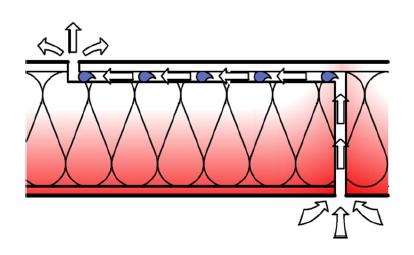

the infiltration source is mainly thought to be used for an infiltration trough the first air-tight layer (from inside). This can cause condensation of water before the next air-tight layer.
Moisture leakage due to pressure differences

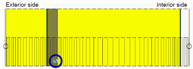

So the moisture source should placed inside the construction close to the next air-tight layer. I use 5 to 10 mils in the wooden sheathing if existing, otherwise in the mineral wool or material which is connected to the air-tight-layer (usually the roofing felt).

the exterior sheating is the most critical case, at is has the lowest temperature und thus the highest amount of condensate. However you can also spread the source over the whoe area and homogeniously distribute it over sheating and mineral fibre - the amount will be the same, as it takes the coldest point of the chosen aerea.
If you put a second source at the more interior part you would deposit the moisture twice.
So from our experience best and most realistic approach is to put the source in the exterior sheathing.
