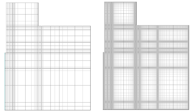

Dear Guy,
thats convergence problems you have.
The main problem in your construction is the numerical grid. Your grid is much too coarse. You have to use a steady-going grid as this shows better convergence behavior, than a size-jumping-grid. Please check the expansion factor. It should not be higher than two respectively lower than 0.5.
Grid left is much too coarse, can cause convergence problems. Right is a nice, steady-going grid.

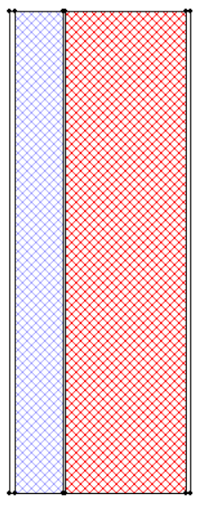

Geometry
Geometry
Here is the geometry. It's a simple wall with brics and EPS insulation.

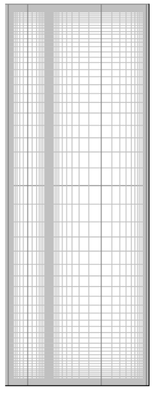

Grid 75x75
Grid 75x75
Griglia 75x75.PNG (21.7 KiB) Viewed 20625 times
I tried with many grids, in order to define the most optimized one in terms of time of calculation and error. However I cannot chose the right value to confront all of them and justify my choice.
I attache here all the grids i tried out.
Thank you again
G.

Re: Processing Error
Posted: Sun May 12, 2019 11:08 pm -1100
First one (75x75) looks sufficient for me.
BTW: I would not optimizing the time of calculation. Let the computer do the work during night.
