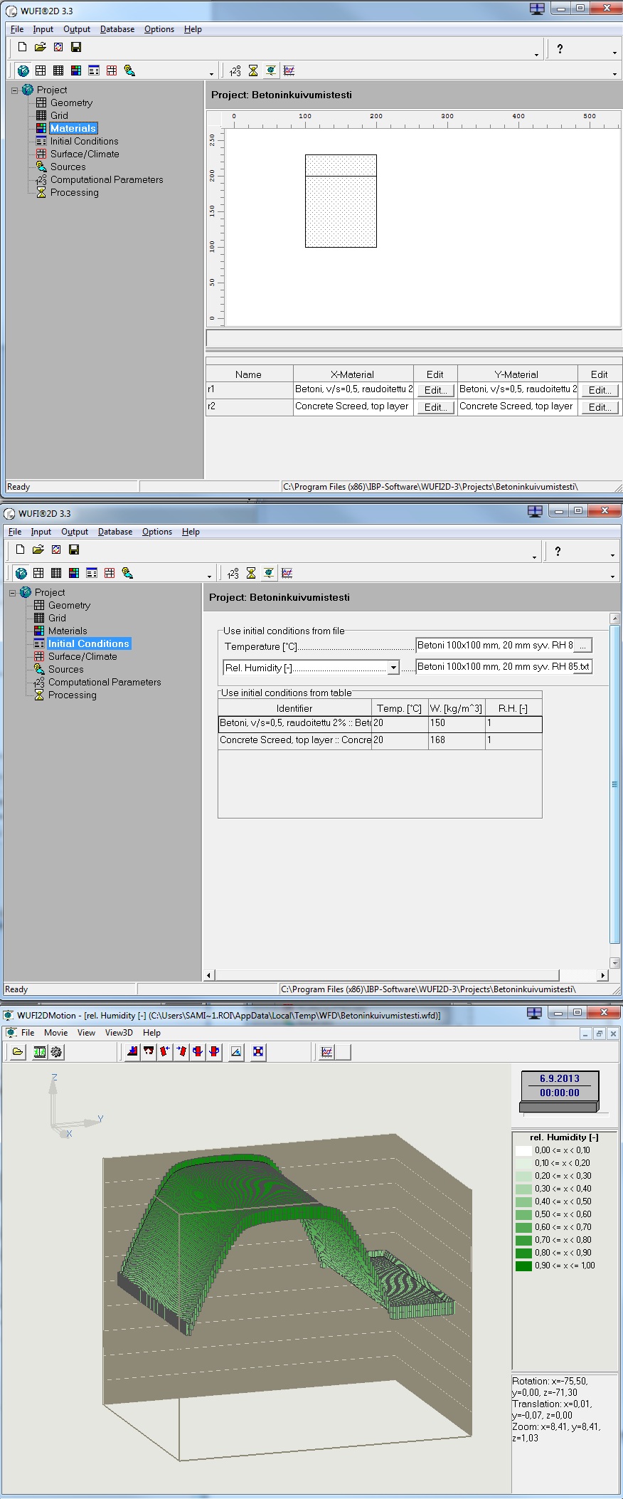

I tried using extracted initial conditions while simultaneously adding materials with different conditions. It didn't work as I hoped.
When I set the initial conditions from a file, the table is greyed out. It seems to set the conditions from the file to the whole model. As you can see from the image, the layer of screed has the same RH as the top grid layer had.
But if it takes the initial conditions from the last grid layer and applies them to the new, extended area of the model, I was thinking maybe I can edit the txt-file itself. If I add one layer with RH 100 % on top of the old grid, it should change the screed's RH to 100 % as well. This might be a bit tedious work-around for this, but for a simple test like this it should be ok.
I hope you can advise me with this!
