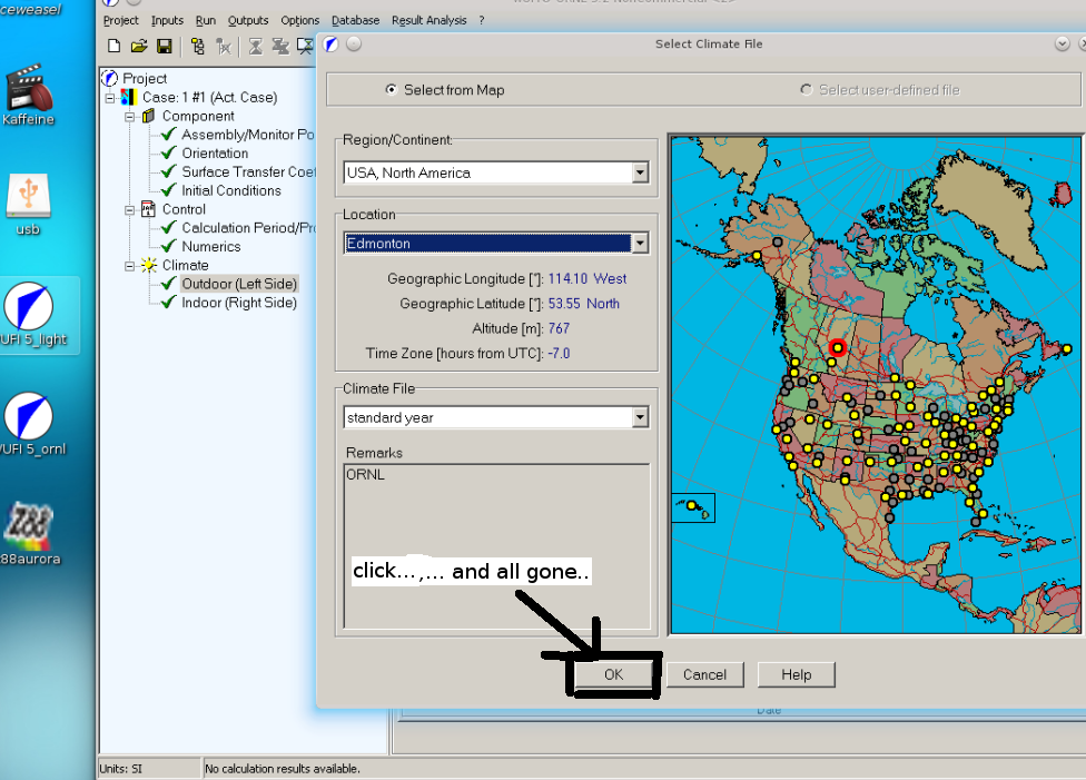

Hello, I've bee trying to get Wufi5.2Light/ornl rel 5.2.0.972 & DB24.76 working. OS is Debian Wheezy & wine 1.4.2. mimicking windows 7, 2000, and so forth. Whatever the proposed win-ver the program suddenly halts =dissappears from the screen completely. This happens when klicking on the OK-button in the outdoor-leaflet. All the other input phases work well, even the material database is accessible but the Outdoor-Select_Climate_File-OK -chain causes a sudden death, but again cancel & help- buttons work well.
Further, whatever the chosen language, only some US-cities are selectable.
Just wondering whether there are users who have faced similar behaviour and succeeded in solving it, be the OS some *nix or windows-based system.
br Vesa Isakov

Does the indoor climate pane work? If not it could be an issue with sse2 instructions in wuficlimate.dll (see post http://www.wufi-forum.com/viewtopic.php ... 2354#p2354). Otherwise I don't have a solution except waiting for WUFI7 (completely recoded using java, native libraries and sqlite-db for win/macos/linux/unix users).

Thank you for your quick response. I do not have my debian-box available right now, must try your instructions later in the evening. As far as I remember the indoor-pane worked, but better not to rely on bad memory.

Yep, it's been tested, no cure whichever wuficlimate.dll-file in use. Wufi behaves as explained earlier. And clicking whatever button in the indoor pane does not kill the program. Apparently I've to wait for wufi7. br vi
