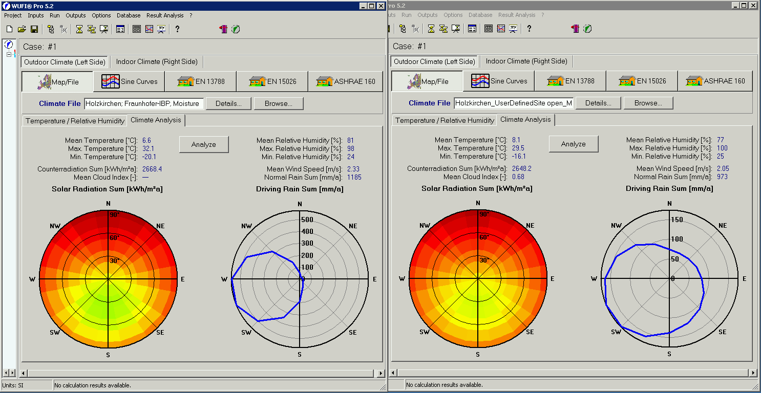

See the attached picture. Look on the driving rain. Left is the Holzkirchen moisture reference year from IBP, right one generated using Meteonorm. The driving rain on a west oriented facade is about three times lower in Meteonorm.
To get more rain on one of your facades you for example could rise the driving rain factor R2 (for example you could multiply with three in the case of Holzkirchen, west facade).

Christian - it's valuable that you posted the 2 weather 'pictures for Holzkirchen (measured vs Metonorm), side by side. Yes, we can see the difference in driving rain, which you say is important.
But most of the other parameters seem to be significantly different too - yet you say all the rest is adequately accurate, only driving rain needs to be adjusted (or allowed for).
So it's interesting that this degree of 'inaccuracy' in all the parameters (except driving rain) is acceptable. It's good to be given a feel of what's OK!

Christian says (I keep checking) that Meteonorm files are good enough, except for driving rain. So mainly I'd be looking at driving rain, but judging from the comparative pics above, there may be significant other differences too.
