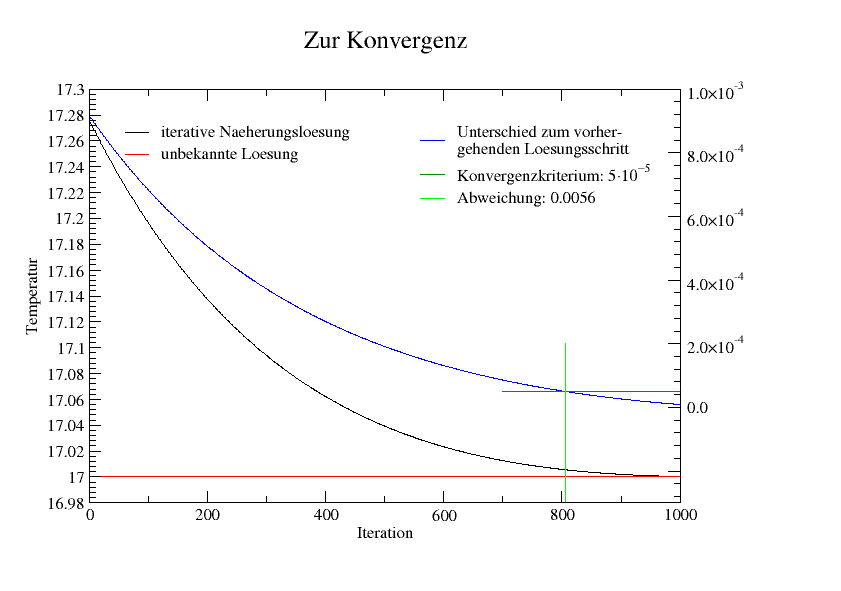

And *** interrupted - maxit too small *** means the convergence criterion was not reached within maxit iterations - which does not necessarily mean you got a "wrong solution" but there is a chance to get a slightly better solution for that specific timestep by increasing maxit. Sometimes one can get some kind of oscillation: current temperature field results in temperature dependent moisture transport coefficients leading to a moisture field yielding to different moisture dependent heat transport coefficients resulting in different temperature field and so on - without finding a "converged solution". WUFI assumes a solution of both temperatur and r.h. as converged as soon as two subsequent solutions of temperature and r.h. do not differ more than "convergence crit." (maximum norm, residual). The independent solutions of both temperature and r.h. are exact for each single inner iteration - but the coupled solution has not underrun the user definable convergence criterion perhaps because of huge nonlinearity.
Following chart (hypothetical values) might illustrate the iterative process and meaning of the convergence criterion.
iterative Naeherungsloesung: iterative approximative solution
unbekannte Loesung: unknown solution (the exact or analytical solution)
Unterschied zum vorhergehenden Loesungsschritt: difference to last solution (residual)
Konvergenzkriterium: convergence criterion
Abweichung: difference between "converged solution" and "exact solution"
The left axis is for the red and the black line
The right axis for the blue and dark green line
The convergence criterion has been reached at about iteration 800 (light green line) and at this point the difference between the exact and iterative solution is about 0.0056 degree celsius.

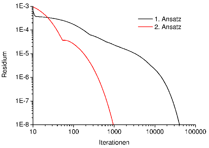

Here comes another chart illustrating the residuals comparing two different approaches of source term linearization.
This shows the real course of the residuals during the iterative process for a single time step.
You can create a similiar chart by setting "Print residuals at iteration modulo" (computational settings/enhanced) to 1. Then redo the calculation and open the "result analyzer" (shows up without logarithmic axis scaling). Do not forget to reset the "print residuals modulo" before saving your data because a value of 1 leads to a really huge "iter.txt" file.
