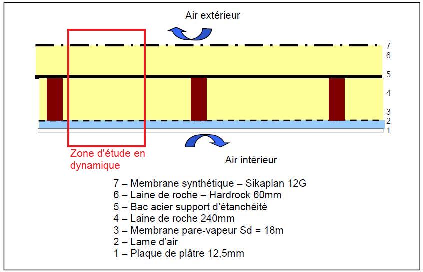

I have the similar problems than Pascal but with a different flat roof composition (as attached picture).
I tried to simulate this roof with two different vapor layers : one with Sd=20m(PE) and this other with a variable Sd value (ie INTELLO).
For the calculations, I chose to inclued radiation and I indicated 0.6 for absorption and 0.9 for emission.
My first question is : Do we need to set Sd value of exterior and interior surfaces if we also created a component layer with them (waterproof layer ans gypsboard).
Do you know why the results are similar with these two differents layers. (same end profile of RH). Which criterion of calculation impact?
thanks in advance for your answer.

Hello Emilie,
if you built in the layer you have not to set an sd-value on the surface and vice versa. On the exterior it is better to use the surface sd-value. On the interior side that is not possible, if you like to calculate a variable membrane, you have to build that in.
You get the same conditions in both cases? Did you set the interior heat transfer coefficient the right way? eg 8 W/m²K?
At which position did you look on the water contents?
