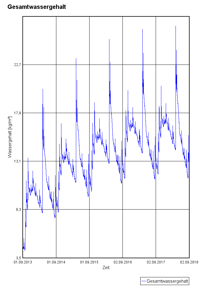

Have reduced the RH from 0.7 to 0.3.
The result has less problemes - iteration interrupted (269 times and only E-0 for theta, phi and rain), and Rain iteration (280 times and only E-0 for theta, phi and rain).
The attached diagram shows still a sudden rising of the water content from 8 to 20 kg / m³. This is not realistic. What is the cause?

Is this a sucking surface? I would guess that there is strong rain event at the time of the jump. I do not think it is caused by convergence failures, as it repeats every year at the same time.

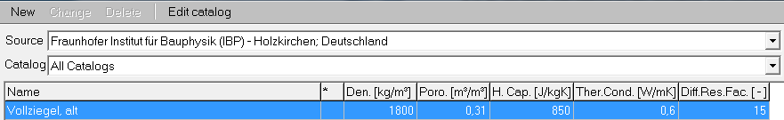

The wall material is old brick from the IBP database. You can see it on the attachment. I wouldn`t say it is a sucking surface!
- Material.PNG (7.72 KiB) Viewed 13533 times
Re: simulation with error!
The Vollziegel has an a-value of about 7 kg/m²h^0,5. Thats quite a lot. Modern plasters are in the range lower than 0,1 kg/m²h^0,5.
See the material properties. If there is a transport coefficient defined for suction, then the material can suck in water from rain.
