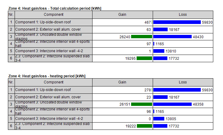

2.) how the heat gain/loss calculated (Kwh)? because some of my component like heavy construction wall with insulation had a quite high heat gain. (see picture attached---heat gain_loss).

2.) This shown gains and losses are related to the inner surface of a component, influencing the inner zone climate. So if you "Retain the calculation results" for a component ( the check box in the result tab) you can store the heat fluxes (per square meter surface area) per simulation time step. If you sum the positive values (the gains regarding the zone) and the negative values (the losses) and multiply the values by the surface area you should get these values for the total calculation period.

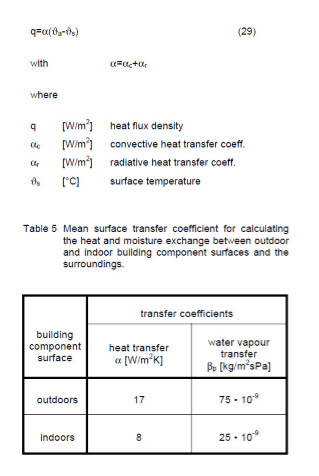

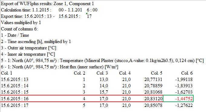

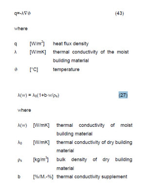

1.) the picture below is the result of a roof component exported from the calculated courses. I need to know how to calculated the Inner surface Heat flux (W/m2) to support the heat gain/loss results. I have tried various formula's from H. Kunzel reseach -"one and two dimensional calculation using simple parameters" (i.e. equation 43 and 27 -second attachment , 29 and table 5-third attachment) but no luck. It's a big help if you can show/give me one example incident in the picture below (marked in red) came up with that heat flux (marked green).

the heat flux on the is calculated with a kind of equation 29 in your second attachment (heat_formlua_2.jpg). But instead of the heat transfer coefficient (alpha) the heat transfer resistance (input parameter in the surface->thermal Tab page) for the exterior or interior surface is used. The equation is:
q = (-) 1/Rsi *(Inner air temperature - component inner surface temperature)
regarding the heat flux for a component defined from outside to inside to be positive.
I presume that your results not show the surface temperature of the inner surface (..., 0,124cm). this lenght represent the depth in the layer. I think this point is insde the component.
