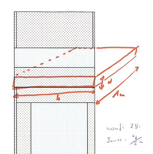

Re: Feuchtequellen in WUFI2D
please see here how the source strength is distributed:
https://wufi.de/de/service/downloads/#2d_quellstaerke
in general, you don't need to take any dimensions into account in order to use a source.
In the two-dimensional WUFI-2D, the user defines a two-dimensional cross-section of the simulated component. The full component is imagined to extend infinitely into and out of the screen, as suggested by the following diagram (which only shows a small portion of the "infinite" extent in the third dimension).
The same is true for all the sources which have been placed into the component. In the example shown, the red rectangle in the component is a heat source, and the full three-dimensional heat source is imagined to be a "stick" extending infinitely into and out of the screen. For example, it might be a heated cable or pipe. Accordingly, the heat or the moisture released by these infinite sticks are counted "per meter" of the stick: The source strength of heat sources has the units W/m, and the source strength of moisture sources has the units kg/(m s).
So you only have to determine how much heat or moisture you want the source to release per meter. Don't forget that the release rate is "per second", so the numbers for the source rates tend to be very small numbers. You can write those numbers to a source strength file which then controls the (possibly time-dependent) source strength during the simulation.
The size of the source cross-section in the assembly does not affect the release rate. WUFI takes the release rate specified by the user and automatically distributes it over the grid elements in the source area, as mentioned by Christian. If you change the size or shape of the source, the release rate of the source as a whole will remain the same (the release rates apportioned to the grid elements will be adjusted accordingly).
It is advisable to make the source area as large as possible, because this reduces the release rate of the individual grid elements and is easier to handle for the numerics. Also, if a moisture source is concentrated in a small area, a relatively large amount of moisture may be released locally in a short time, saturating the material at that spot and preventing further release of moisture until the previously released moisture has dispersed enough to allow the release of new moisture.
A possible application for a moisture source, and a case where the component dimensions must be taken into account, is this: You may wish to add a weak moisture source to a component in order to challenge the component's drying potential. For example, you may want to release 250 g of moisture per square meter of a roof during three winter months. The source is to be located in some wooden board within the roof.
The desired release rate refers to a square meter of the board which contains the source. However, in WUFI's 2D-assembly, that board is represented by its two-dimensional cross-section and the release rate to be specified for the source is counted per meter of the board vertical to the screen. If the cross-section of the board has a length of one meter (the width is irrelevant), then the board has an area of one square meter for each meter vertical to the screen. In this case the release rate for the WUFI-2D source would be 250 g per meter and per three months (= 3.17e-8 kg/(m s)). If the cross-section of the board in the assembly is two meters long, then the board has an area of two square meters for each meter vertical to the screen, and the release rate for WUFI-2D source would be 500 g per meter and per three months (= 6.34e-8 kg/(m s)).
And finally, if you use WUFI's options to specify the heat or moisture source strength as a certain fraction of the incident solar radiation or driving rain, WUFI does all these conversions for you, and you only have to specify the desired fraction.

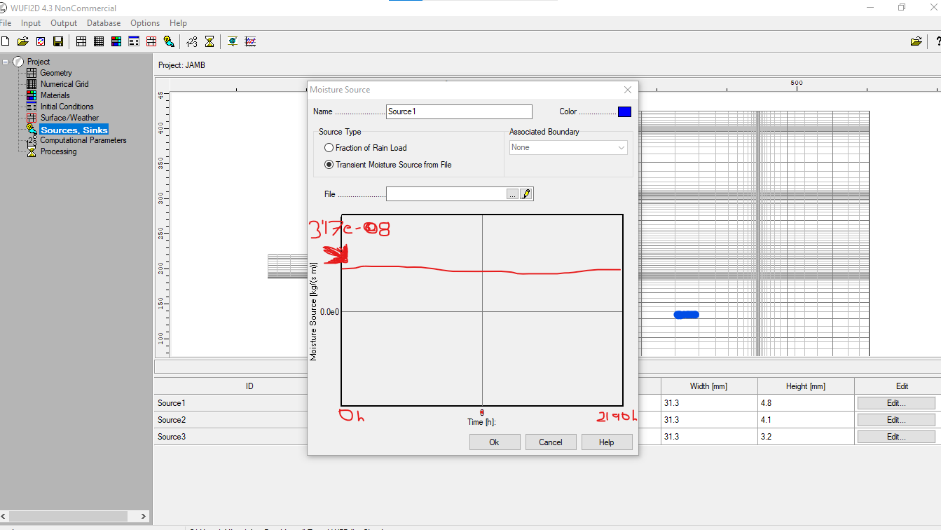

thanks a lot really good explanation so I hope to have understood it
then, in your example you will add a cte value during 3 month to one grid element to analyse the drying potential of your assembly see image in case of using more grids elements as you recomend you divide that source strength for each grid element that made up the whole grid area using the ratio between the total area of all grids elements together (sum area of each grid element individually) and the area of each grid element
Am I right?

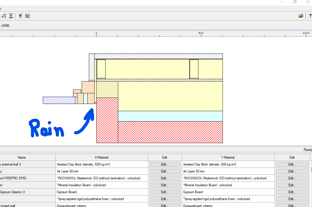

another question, could you tell me how you would determine (in a real case) the moisture source of an exisiting window jamb due to the rain incident? would you measure the moisture that enters between winfdow frame and wall? which positions would you choose for your source strength? how depth from the window frame surface? would be that moisture source placed in the insulation between wall and frame? would the part of moisture source be included in the cavity closer as well? i am sure I explain my doubt really bad but I am quite new in this and I would like to know the procedure to carry out an simulation/analysis of a real case for a construction detai).
what about the air infiltration from inside? how would you take into account in the simulation?
Am I right?
- jamb moisture source.png (40.18 KiB) Viewed 95442 times
Hi Alberto,Alberto Morales wrote: Sat May 28, 2022 1:47 pm -1100 then, in your example you will add a cte value during 3 month to one grid element to analyse the drying potential of your assembly see image moisture source.png
WUFI will automatically distribute the user-specified source strength over the grid elements which are in the source region; you don't have to do this yourself. (The procedure is as you describe, but WUFI does it for you.)
All you have to do is to specify the location, shape and size of the source region, and to specify a source strength (either as a fraction of the incident solar radiation or rain, or as a file with explicit, possibly time-dependent source strengths).
You don't necessarily need to include in all simulations a moisture source which simulates moisture leakages. It is an option in case you wish to "challenge" the drying potential of the construction by releasing some leakage moisture. If this is of no concern in your simulations, you can omit such a source. If it is of possible concern, you usually have some idea where the leaking moisture may appear in the construction. For example, some wall constructions inlude a weather barrier membrane; a typical spot for leaked-in moisture to appear will then be on the exterior surface of this membrane. In other cases, localized gaps or cracks may serve as entry points of moisture, the details will depend on the specific construction.another question, could you tell me how you would determine (in a real case) the moisture source of an exisiting window jamb due to the rain incident? would you measure the moisture that enters between winfdow frame and wall? which positions would you choose for your source strength? how depth from the window frame surface? would be that moisture source placed in the insulation between wall and frame? would the part of moisture source be included in the cavity closer as well?
In general, the exact location of the leakage source will not be very important, because it will usually release a relatively minor amount of moisture which will spread within the construction and, in most cases, automatically end up in critical (for example, cold or vapor-trapping) locations. On the other hand, if you specifically wish to investigate a case of leakage, you will know where the potential problem occurs. You can even use WUFI to investigate the consequences of different leakage locations by running and comparing a series of relevant simulations.
There's a "Guideline for Using the Air Infiltration Source in WUFI" in the downloads section of the WUFI website.what about the air infiltration from inside? how would you take into account in the simulation?
