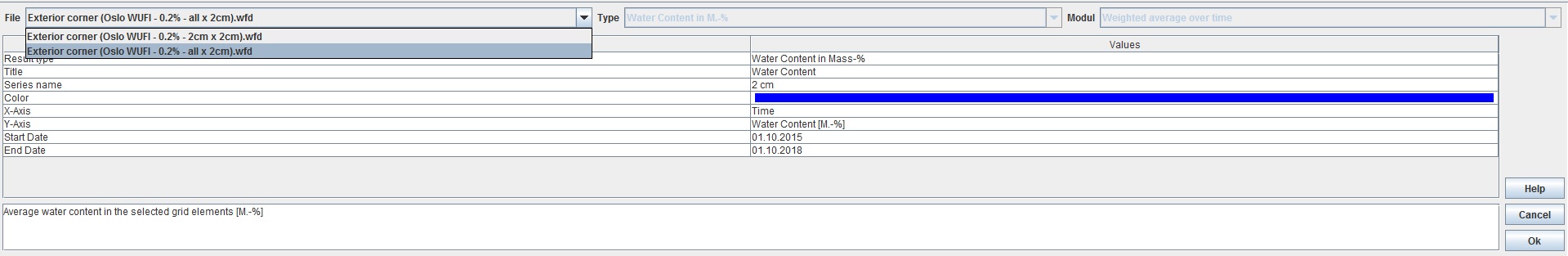

Re: WUFI Graph - Graph with data from 2 files
Hello Christian,
Thank you for your answer. If I draw a first curve from a result file and then choose another result file in upper left window (then select the part I want to study and then clic OK), the result file used in the options of the curve (user define window - right clic in the name of the curve - options) is the first one and not the second one.
Sorry if I'm not clear enough...
Thank you again
Bastien
Thank you again
Bastien

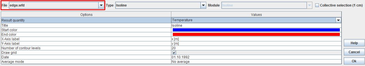

Hello Bastien,
are you sure that over here (see red box) the right file was set as well? What version of WUFI Graph do you work with?
Hello Christian,
Yes, as you can see, the two files are set.
If I choose a first file to draw a first curve and then select the other file to draw a second curve, the file used for the second curve is still the first file...
I use WUFI Graph 2.5.2.
Bastien
Bastien
