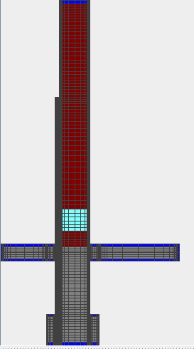

I would like to reiterate my question.
If I have a construction like this:
Selected area for graph 1.PNG (9.7 KiB) Viewed 23966 times

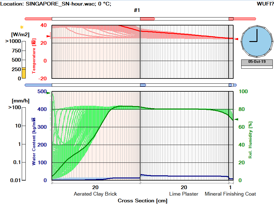

and I would like to visualise the water content of the selected area in the graph, Iis it able to output a graph similar in WUFI 6:
WUFI graph.PNG (76.83 KiB) Viewed 23966 times
, where the water content can be visualised across the different layers at a specific time.

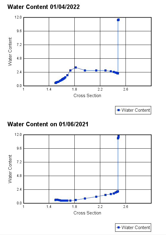

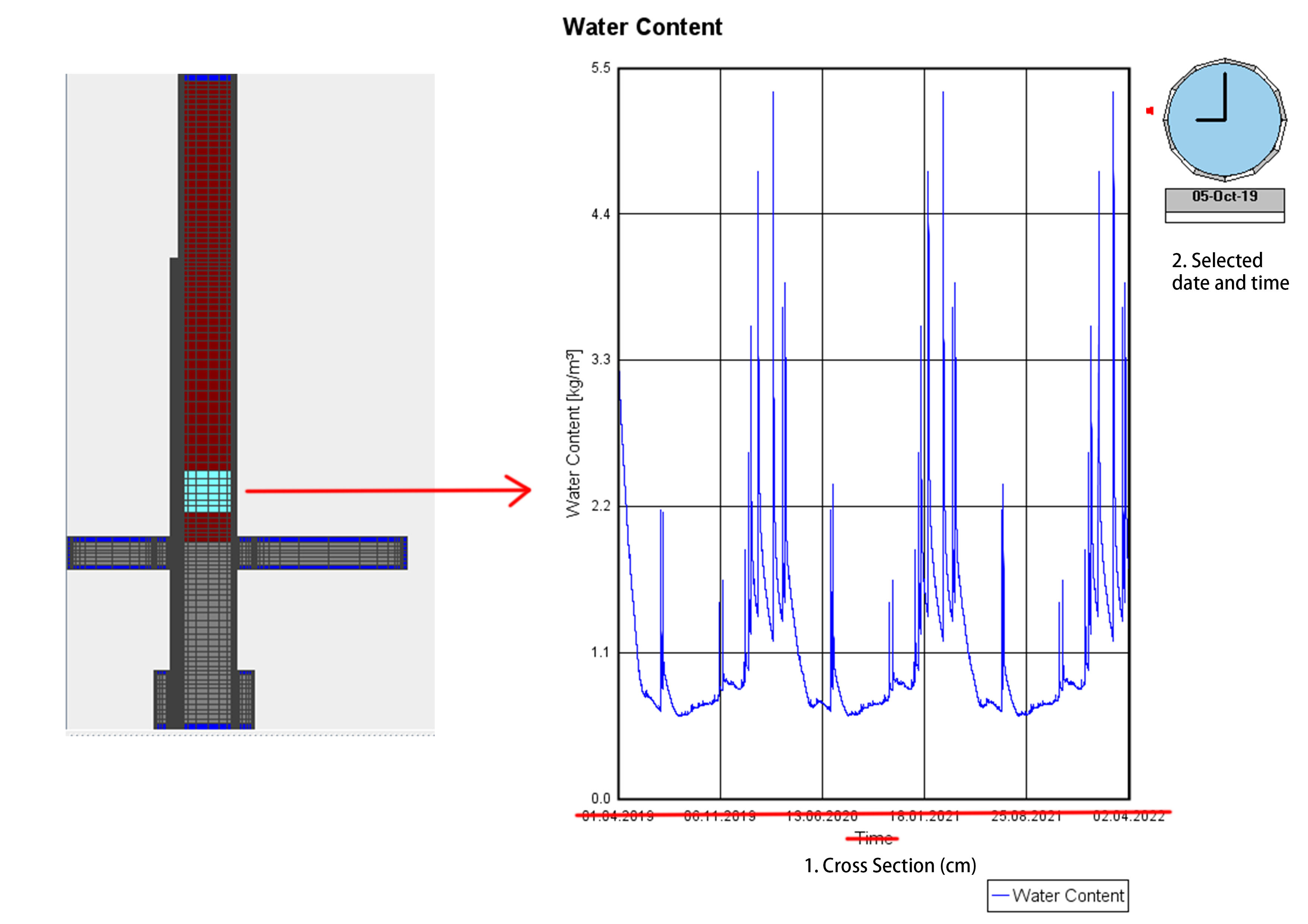

If not, could I achieve an output similar to that of :
wufi graph 2.jpg (550.95 KiB) Viewed 23966 times
Re: Wufi Graphs - temperature/distance
Hi Annie,
yes, that is possible.
Select the type user-defined an there the module: Profile along cross section.
See the WUFI Graph help for more information.

Dear Christian,
Thank you for the prompt reply, I have successfully created the profile graph.
Water content profile.png (20.21 KiB) Viewed 23961 times

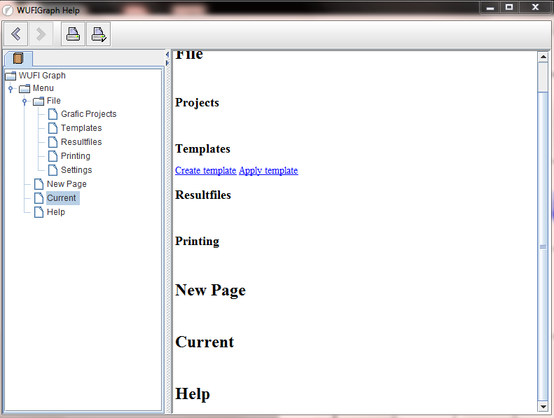

However, I am unable to access the Wufi Graph Help on the software. Is there a web version that I can download? I have tried finding on the website but was unable to find it.
wufi graph help.PNG (58.31 KiB) Viewed 23961 times
Which version of WUFI Graph do you use?
With the newer versions there is a pdf-help usually here:
c:\Program Files (x86)\WUFI\Tools\WUFIGraph\help\WUFIGraph_en.pdf
