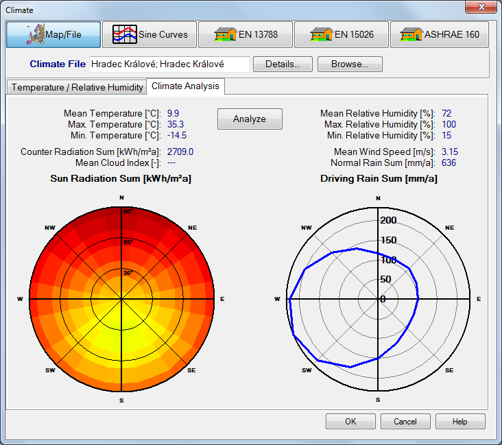

I simulate temperature and moisture processes around the hole in a contact ETICS insulation and I use the climate file selected from the map /Hradec Kralove/. The hole is round opening in the plaster and EPS, about 10cm wide and 10 cm deep, and the insulation is 5 mm distant from the wall. Does it contain the climate file driving rain or should I still add the moisture source to the hole or to the air laier ?
I would like to check out the dates in the climate file, to find out amount of rainfall,... How is it possible ?

You can get some information about the rain in the climate file on the climate analysis tab: As we are not allowed to give out the climate files in ASCII, they are in a binary format, on which no further analysis is possible.
