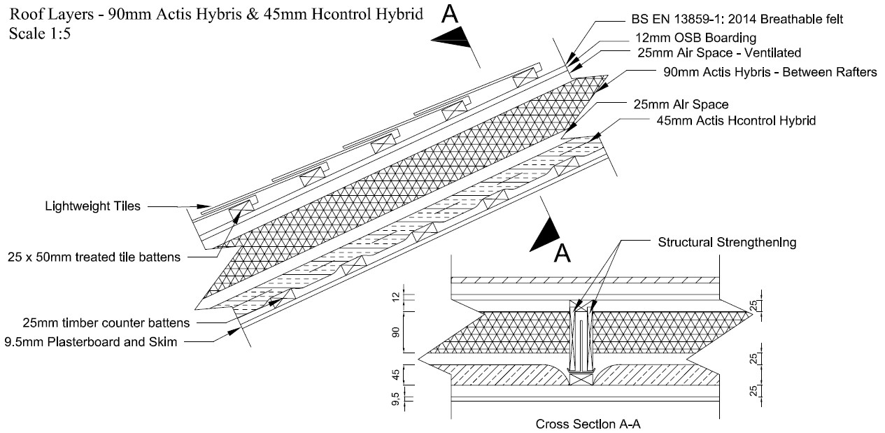

1. the roof structure
2. a actis insulation material
3 the multifoil insulation
if you could let me know if this can be modelled and if so would i need to build each individual layer of the multifoil to accurately gauge performance.
