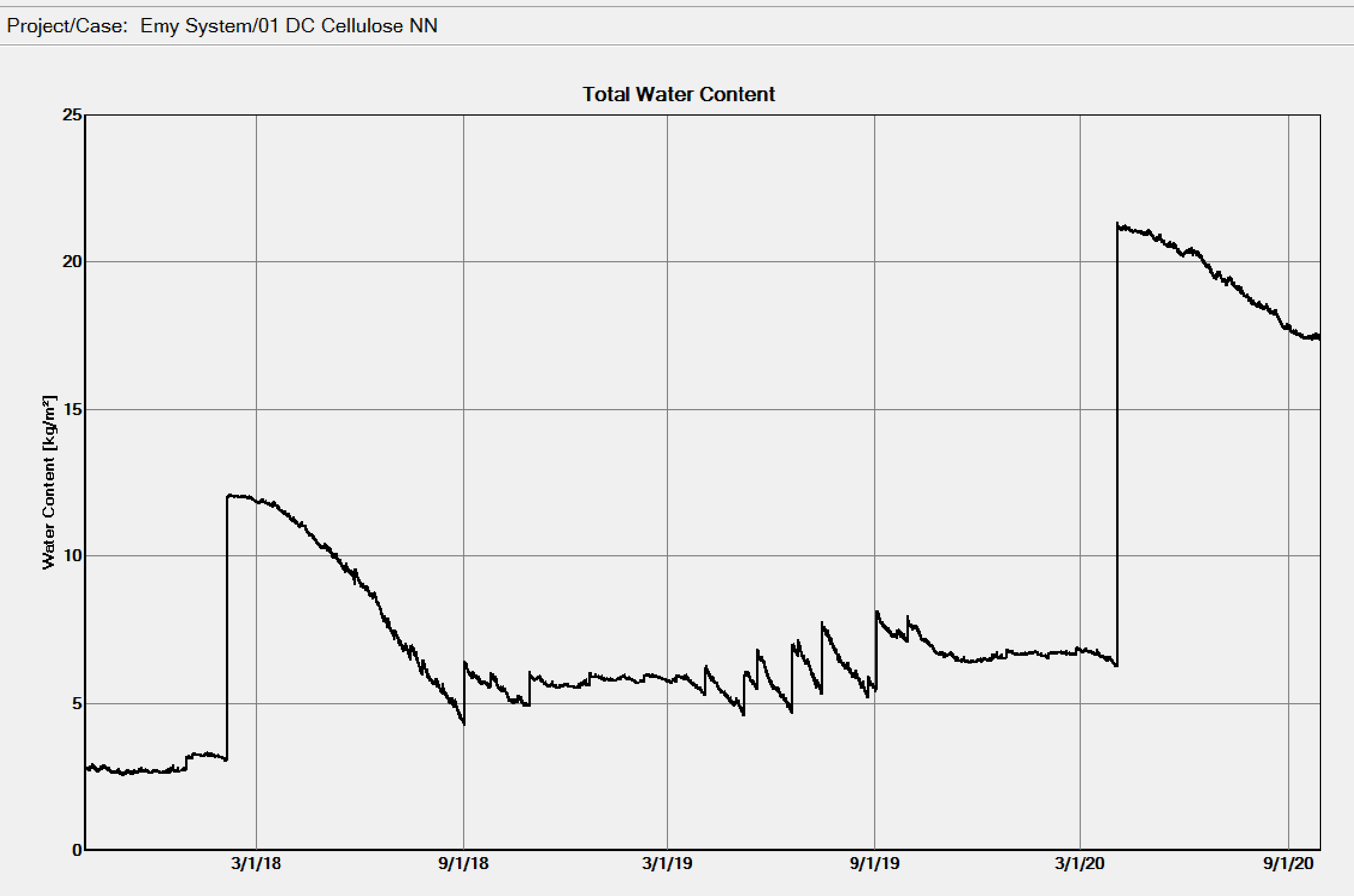

I'm using WUFI 6.1 and I'm having trouble with analyses in colder climates (northern US, Canada).
In milder climate zones, all works fine.
In colder climate zones, the two balances diverge dramatically. Balance 1 has usually positive values, while Balance 2 has negative values.
The latest calculation I got Balance 1 = 14.43 kg/m2, and Balance 2 = -42.78 kg/m2 (2410 convergence failures).
See attachment for total water content over 3 years calculation.
Thank you!

Hi Enrico,
The reason may be the occurrence of more interstitial condensation in cold climates.
Did you try to use the adaptive time step control in the Control - Numerics settings ??
