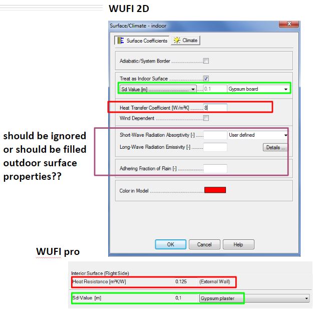

I try to model a wall construction in wufi 2d that already I have done it by wudi pro. I need to have exactly input data and settings in both of them , but when I select the ' Treat as indoor surface' there are some input and settings that are related to the outdoor surface such a 'Adhering fraction of rain and long wave radiation emissivity '. I don't know what should I do about this items when I select indoor surface? Should be ignored because they are not in WUFI pro in related to indoor surface!!Picture in attached shows my means clearly.
I would be appreciate if you could help me please.

just ignore that part, WUFI 2D will do the same.
