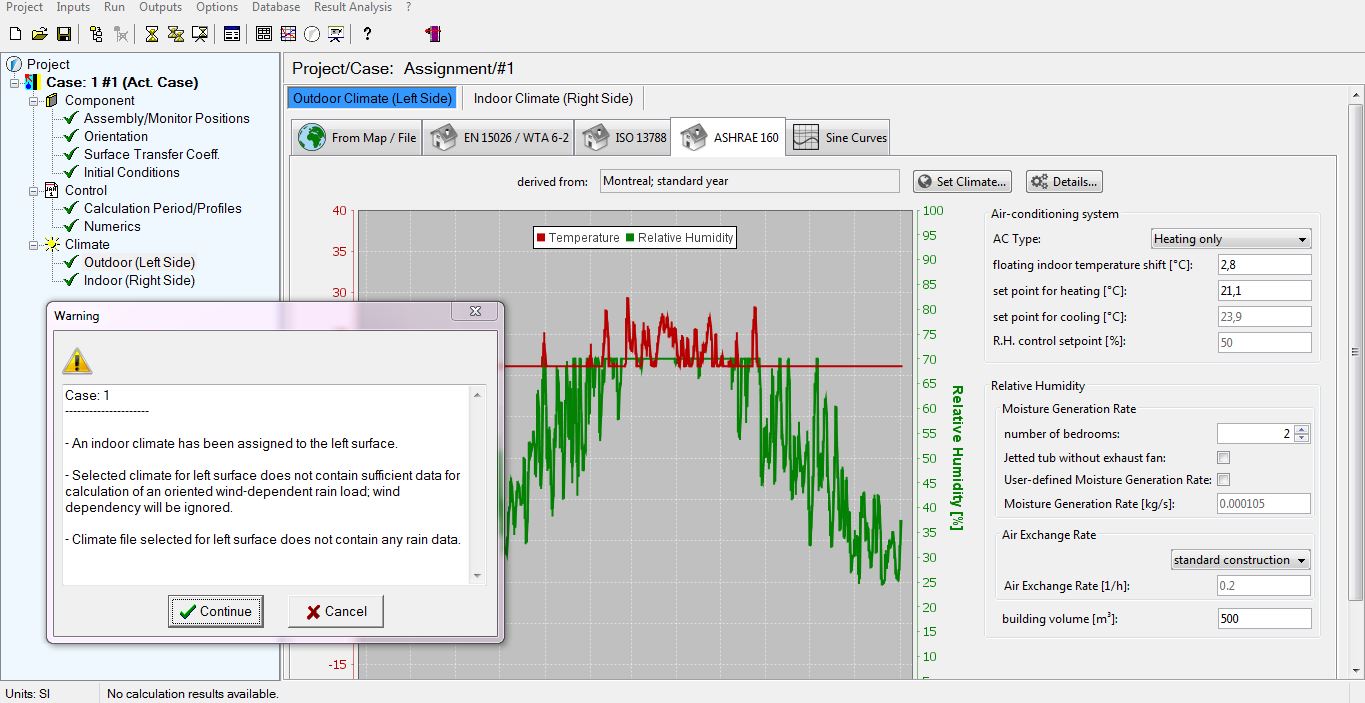

Before running I have faced a error.
I have attached the picture of this error here. Could you please help me?
I think, every thing is ok, but I don't know what to do

Please see the blue marked part in your screenshot. You probably want to assign the ASHRAE 160 model to the indoor and not to the outdoor climate

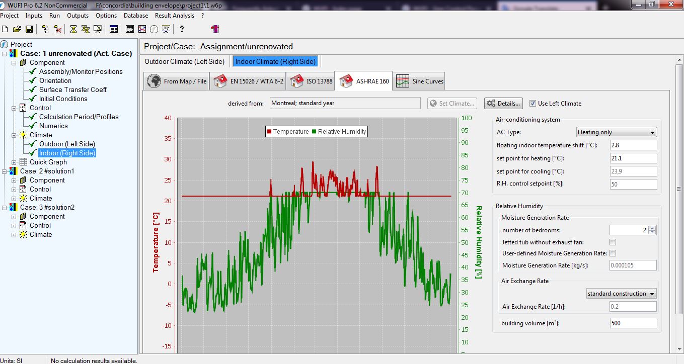

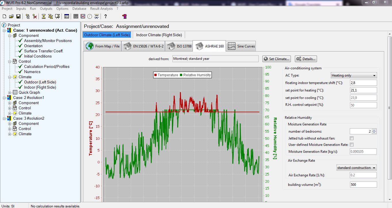

I have chosen Ashrae 160 to indoor and outdoor, and select "Use Left Climate"
Please find new attachments in which Outdoor and Indoor options are shown.

If this is what you want then it should be fine to go. It is a warning and not an error.
