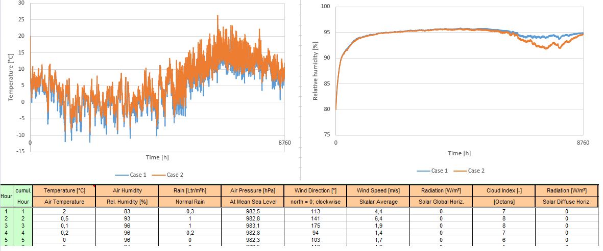

I am simulating a roof with 30°slope in WUFI 2D, the roofing felt under the metal deck (the metal deck and air space is not simulated, rain turned off).
I have created a weather file with data from a meteorological station.
I did not receive any data on counterradiation from the station.
In the figure below you can see the variables in my .WAC file and the difference in simulations.
Case 1: gypsum elements under roofing felt simulated with explicit radiation balance.
Case 2: gypsum elements under roofing felt simulated without explicit radiation balance.

4. What explains the difference (small) in relative humidity and temperature seen on the plots below?
The loss of energy due to overcooling

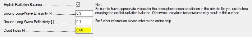

1. Yes using a annual constant cloud index which you can change in your inputs
I have hourly cloud index in octans in my weather data for Iceland (as seen in the figure before).
i. Does the annual constant cloud index, (which I presume is the 0.66 from the figure below), overwrite the hourly octans cloud data?
Cloud index:
Describes the fraction of sky which is covered with clouds. Allows estimating the atmospheric counterradiation if no measured data are available.
ii. Is the value 0.66 an average for most locations in northern Europe e.g.? Can I find this value for Iceland?

i. Sorry I have overseen your cloud index input data. In case the the hourly input will be used and the constant value (0.66) will be ignored
ii. Not sure, I think I went through a bunch of climate files back in 2007 or so and figured that 0.66 is reasonable number.

i. So my understanding is that the counterradiation is therefore estimated from the cloud octans of every hour from my weather data (even though 0.66 is the input there).
