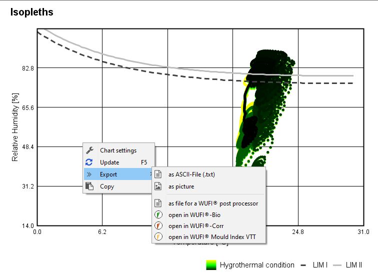

Now I am using WUFI 2D and I want to post-process the mould risk in my construction from the results of the simulations.
Does there exist an Add-on, post-processor or a way to do this?

if you generate an isopleths diagram in WUFI Graph, you can do a right click on the diagram and export directly to use in the installed post process modules:
Please note: that only works if only one course is in the isopleth diagram.
