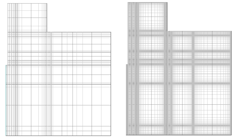

I'm struggling to get usable results out of a foundation detail.
The construction is a SIP panel on a concrete waffle slab (on ground) with a floating floor over.
The calculation runs for about 5 seconds at a normal speed and then suddenly speeds up and completes 99% in a further second or two.
The results, unsurprisingly just show a straight line in all graphs.
I've tried deleting the moisture sources, air cavity and membranes to see if this is the problem, but the calculation still doesn't return anything useful.
Am I missing something obvious?
Processing Error
Processing Error
- Footing 2D.zip
- (451.34 KiB) Downloaded 1470 times
Re: Processing Error
Dear Guy,
thats convergence problems you have.
The main problem in your construction is the numerical grid. Your grid is much too coarse. You have to use a steady-going grid as this shows better convergence behavior, than a size-jumping-grid. Please check the expansion factor. It should not be higher than two respectively lower than 0.5.

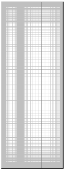

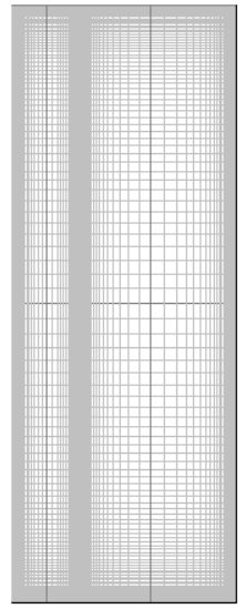

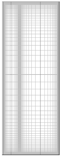

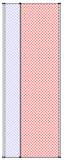

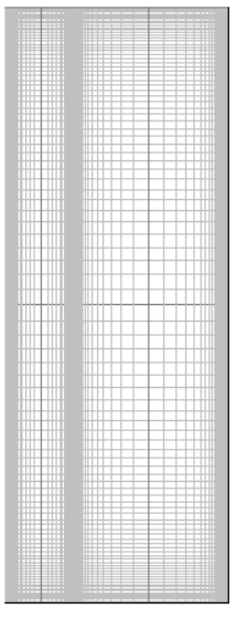

Here is the geometry. It's a simple wall with brics and EPS insulation.
I tried with many grids, in order to define the most optimized one in terms of time of calculation and error. However I cannot chose the right value to confront all of them and justify my choice.
I attache here all the grids i tried out.
Thank you again
G.
Thank you again
G.
First one (75x75) looks sufficient for me.
BTW: I would not optimizing the time of calculation. Let the computer do the work during night.
