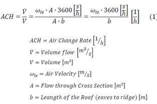

Another possibility is to calculate your own air change rate, based on the hourly mean wind speed and use a transient file. After the following equation you can estimate the ACH. A is the Area of the air gap behind the cladding 1m x the width of the air gap and b is the height of your wall. But keep in mind, here are no flow resistances included and the wind direction also plays a role in reality. So treat this with caution, it seems more appropriate to simulate two constant ACH.
