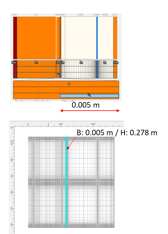

Hello
I saw the description above but unfortunately I still feel unsecure how to convert the WUFI 1D source the right way into a WUFI 2D source.
I have the following WUFI 1D infiltration source (width 5 mm) which I want to convert into a WUFI 2D source (width 5mm, hight 278 mm):
Do I have to multiply the WUFI 1D data with 0.005 m or with 0.278 m to get the right unit for the WUFI 2D source?
Thanks a lot for your help in advance.
Greetings,
Barbara
Re: Air infiltration
Hi Barbara,
you have to multiply with the height in your case (278mm).
See also drawing over here:
viewtopic.php?f=15&t=1103#p3166
