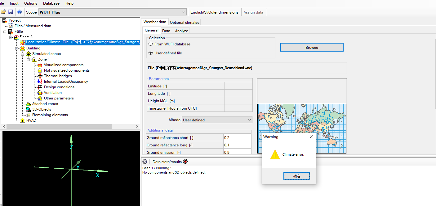

I have a question about loading the external climate file. When I load the external climate file, it keeps showing a climate error, but the same file can be loaded by other students. I would like to ask what is the reason for this and how to solve it. Thank you!

This could be related to the name of your folder. Please verify if the climate file will be loaded correctly from a path that contains only ASCII characters.
