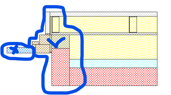

- Posts: 96
Re: Material properties/Functions
ok, as it is glass, it does not make sense to check water content or RH in there, is that what you mean (see area with a cross)? but I can assess water issues in the window frame or insulation around the window and surroundings areas (see tick area)?
- tick.png (22.11 KiB) Viewed 65974 times
Johannes Amos
- Posts: 4
- Joined: Sun May 29, 2022 11:08 pm -1100
If you simplify the frame this way, you can not access the moisture distribution in the component - only the the water content of the whole layer can be evaluated... Further you can assess the surrounding components. What material is your window frame made of?
