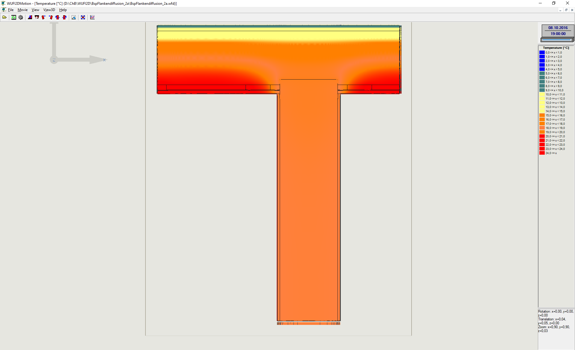

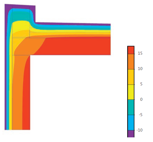

2. Is it possible to generate an image, either in WUFI PRO or WUFI 2D where the effect temperature progression will be visible in colours (a classic thermal image) see picture in the attachment file.
Thanks
Karel
Influence of thermal bridges
- Effect of temperature progression
- Picture.png (71 KiB) Viewed 52781 times

1) WUFI Pro can calculate a single section through the assembly. The rafters are usually not included as the relevant section is the section through the insulated cavity. You may include them by generate effective values.
2) You can generate such "thermal images" with WUFI2DMotion from the WUFI2D results - see below. Please keep in mind that WUFIs main focus is the dynamic thermal and moisture behavior. So its not thought to be used for calculating static heat bridges.
