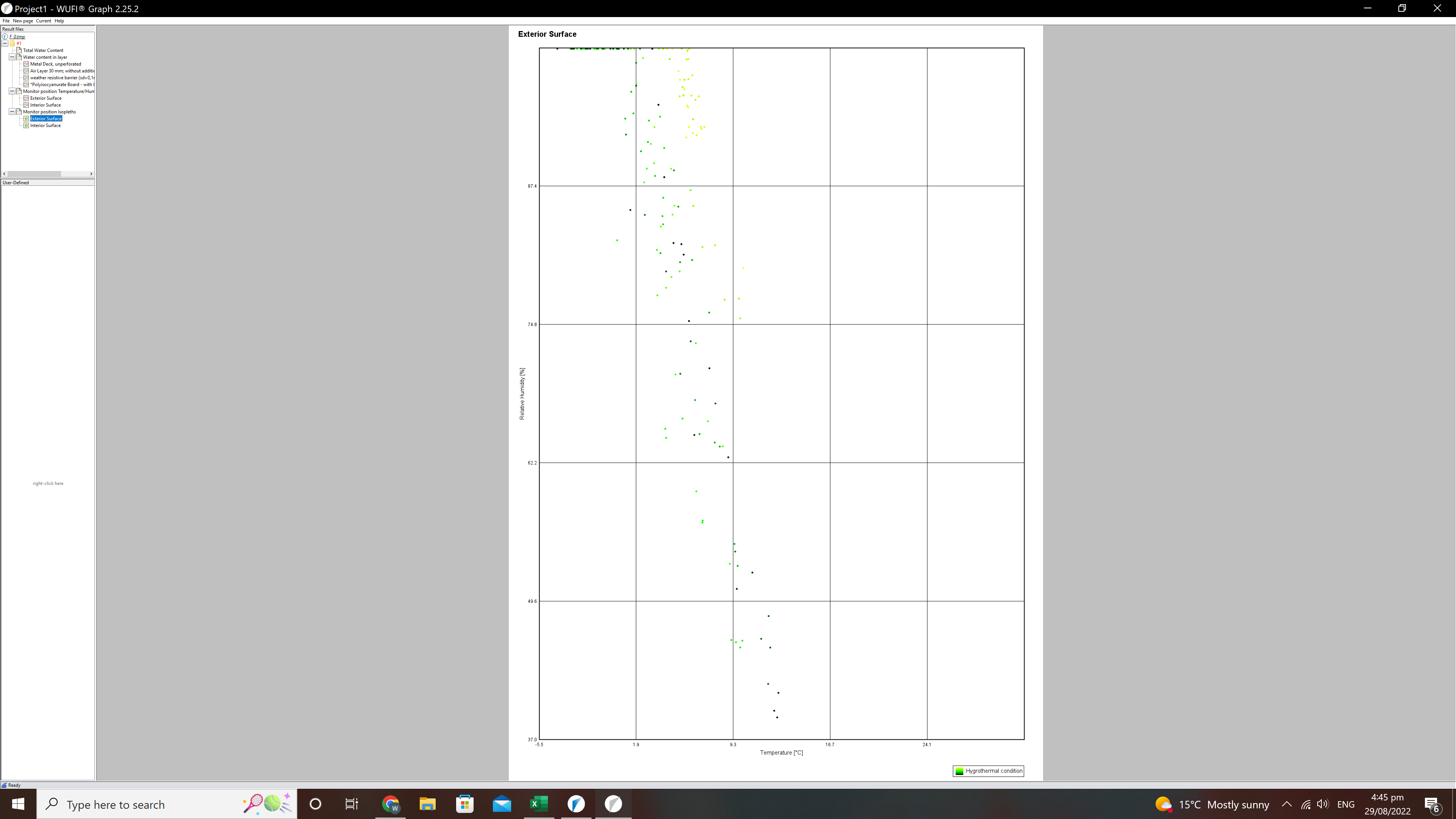

Dear experts,
I do not know why the resolution of the WUFI on my screen is weird. The characters in the GUI look blurry.
The characters in the WUFI graph are too small. Please see the picture below.
Any idea how to fix it? Thank you in advance.

Simply run the HiDPI_add.reg file from the folder C:\Program Files\WUFI\jre and restart WUFI Graph.
This will improve the scaling of all postprocessors. You can undo the changes by running the HiDPI_remove.reg file.

Thank you so much, it actually works.
