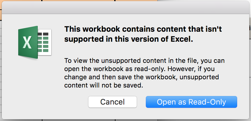

Hello Christian,
Thank you for your reply.
I found two Excel files in the folder you told - one for 2007 and newer Excel version, and one for older ones.
Unfortunately, neither seems to be working for me. I'm running Excel 15.27 for Mac and I can only open the two Excel files as read-only. I can open the file and enter any data I want, but I cannot export it to a .WAC file.
Is there a version of those files that is compatible with Excel on a Mac computer?
Thank you very much,
Enrico
Enrico

- Posts: 1313
Re: Custom Indoor Climate
Dear Enrico,
I found an article concerning that here:
https://answers.microsoft.com/en-us/mso ... 8d1b8211c8
So CreateClimateFile.xls may not work on Macs excel. Maybe try to find somebody with a windows version to use the macro for you.
