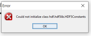

I try to open WUFI Graph after a simulation and get the following error message: "Could not initialize class hdf.hdf5lib.HDF5Constants", see image below.
WUFI Graph was working fine last week on the same computer, so I do not know why it is not working now. I have tried to create a new file to see if I have unintentionally changed some parameters, but the same error shows up. I also tried to reintstall WUFI, but that did not work either.

in the first step I would not play around with Java. WUFI normally includes the JAVA version which is used.
Please try to download the latest version of WUFI 2D, reinstall and see, if the issue still appears.

I have completely uninstalled and reinstalled the program, but unfortunately it still does not work.
I do not have Java installed, nor have I touched any Java files at all.
I have downloaded the newest version from the website.
The version I am using is WUFI-2D 4.5 and WUFIgraph 2.25.2.
The error shows up when I try to open WUFI Graph after simulation.
Do you have any idea what the problem might be?
The error trace is the same every time:

in this case please send us the log files graph.log and wufi2d.log to support@wufi.com.
You can find them in the folder
Code: Select all
%appdata%\wufi\logs
(you can copy that in your file explorers address field).
