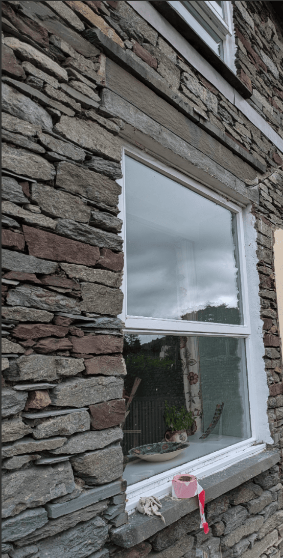

I am trying to model a uk lake district slate stone wall, hopefully I have attached a picture, I have searched through the wufi database and while I could find plenty of sandstone and limestone files, I could not see anything similar to slate.
Does anyone have any suggestions or advise?

Hi Josh,
for slate we do not have any material data - maybe use something like lime stone or something like that.
You could do a worst case assessment assuming that only the mortar can transport moisture throughout the wall and model it only from mortar.

Thank you, I will give that a go. I assume by mortar you are refering to 'Hydraulic Lime Mortar, Fine'?
I believe that is what is recommended to use for sand and limestone walls?
