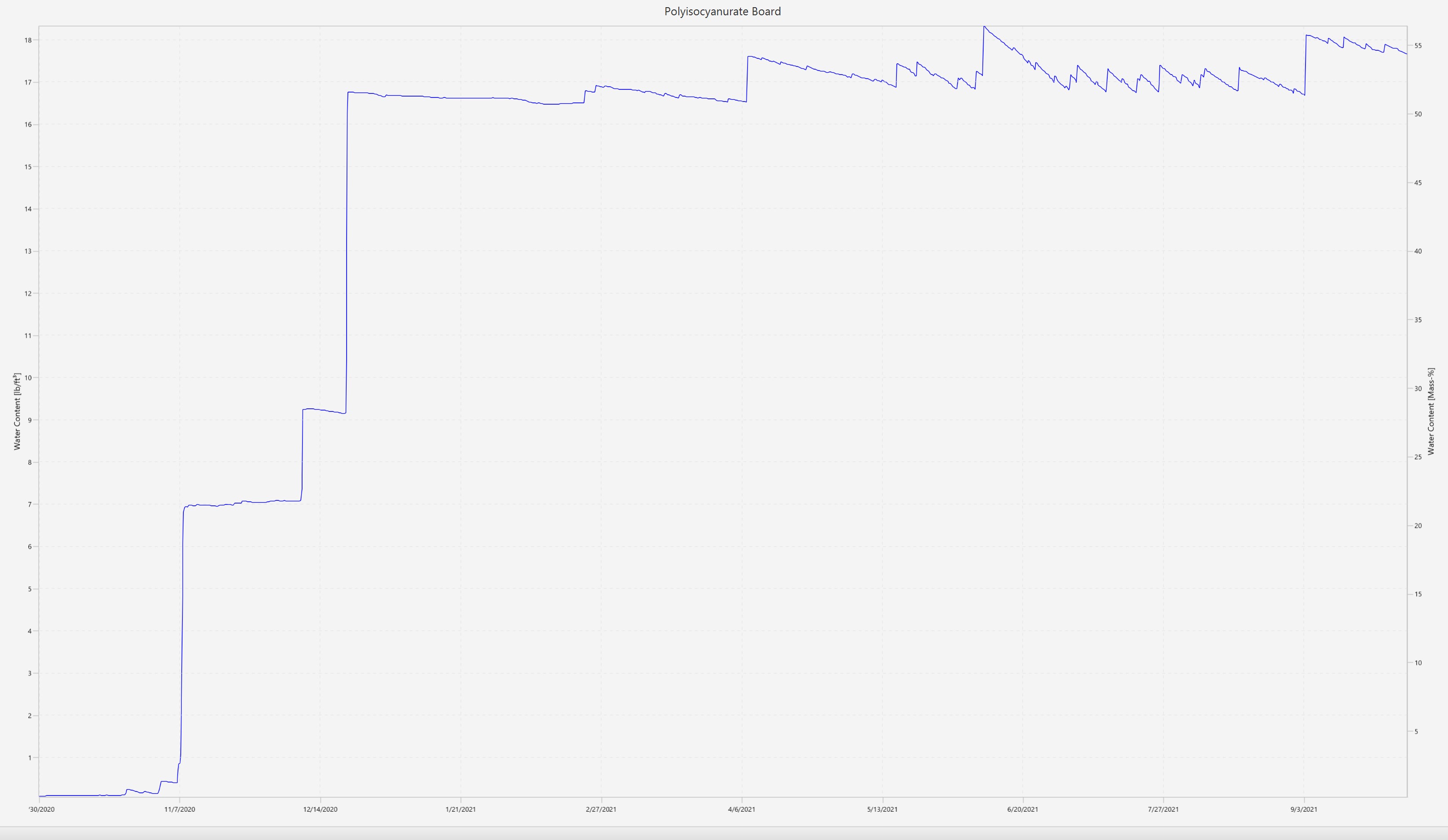

The graph for 'Results>Courses>Water content in materials>specific component' has water content on the left axis that makes sense, for example, values from 0 to 18 lb/ft^3 for this component.
However, when printing the 'Case data summary>result graphs', for the very same component, the left axis values are 0 to 300 lb/ft^3.
This makes the printed report unusable in WUFI 7, and I have to go back to WUFI 6 for it to work.
Thank You.
Re: WUFI Pro 7.1.9.1 bug
yes, sorry for that, thats a bug, thanks for reporting and sorry for the inconvenience.
We will solve that as soon as possible.
By the way, did you check your balances? Your course looks like there are problems in the convergence. If the balances differ much, the results should not be evaluated.
We just released WUFI Pro 7.1.10.3 where this issue is fixed.
