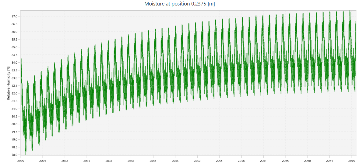

When the calculation is run, there is a huge difference in the Balances (more that 100x difference 9kg vs 1111kg) and c. 2000 convergence errors as the total moisture content increases but does level out over 50 years. There is no significant improvement in the convergence errors or balances when using Adaptive Time Step control. For the north elevation, the calculation time period needs to be 50 years to see a levelling out of the total moisture content in the wall because at 25 years it is still increasing (all other elevations follow a general drying out trend). At the end of the 50 year modelling period, for the north elevation, the RH levels of the woodfibre insulations are shown to have annual averages of c. 85%. See the graph. This is at the interface of the woodfibre and diathonite layer.

- WT01-North-RH.png (200.44 KiB) Viewed 17792 times
