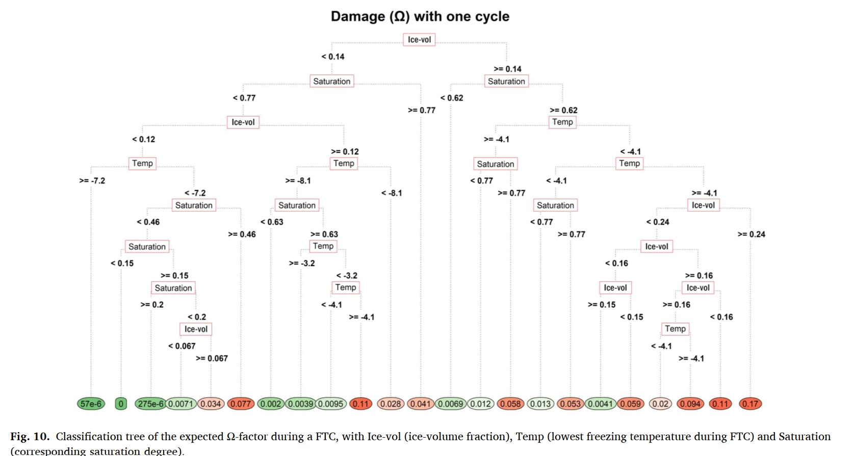

Is there a way to output from WUFI the ice content in a component?
I'd like to use the Jansenns paper to assess the risk of frost damage
Screenshot 2026-03-30 210037.jpg (152.69 KiB) Viewed 22628 times
https://www.sciencedirect.com/science/a ... 2324002415
Thank you

WUFI does not directly output the ice content since this has not been of major interest so far. However, you can compute the ice content from WUFI's standard output.
For liquid water and frozen water to be in equilibrium, they must have the same vapour pressure. Usually, at temperatures below freezing the vapour pressure of ice is lower than the vapour pressure of (subcooled) liquid water because in the ice crystal lattice the water molecules are bound more tightly than in the liquid water. For example, at -10 °C the vapour pressure over (subcooled) liquid water is 286.2 Pa, whereas the vapour pressure over ice is only 259.7 Pa.
However, if the liquid water is exposed to some tension (negative pressure), its vapour pressure is reduced. The capillary forces in the capillaries of a porous material are doing just that: They create a capillary tension in the liquid water and thus reduce its vapour pressure. If at -10 °C the vapour pressure in some capillary is reduced to 259.7 Pa, this specific capillary has just the right radius r0 to create a capillary tension which reduces the vapor pressure of the liquid water to that of the ice at this specific temperature. The equilibrium value of the relative humidity above the meniscus in this capillary and at this temperature is 259.7/286.2 = 0.907 = 90.7 %. In smaller capillaries the tension is higher and thus too high for equilibrium between liquid and ice, and all the water remains liquid at this temperature. In larger capillaries, the tension is too low for equilibrium at the current temperature, and the water is frozen.
In the steady state, the water contained in a porous material collects in the small pores (which have higher 'suction' power) while the large pores remain empty. If at -10 °C all the filled pores have a smaller radius than the r0 described above, all the water contained in the material will remain liquid. If there is enough water in the material to also fill pores with larger radius than r0, the water in those larger pores will be frozen while the water in the pores smaller than r0 remains liquid.
So in order to determine the amount of ice in the material, we must determine the critical pore radius r0 corresponding to the current temperature of the material and see whether the radius of the largest filled pores is smaller or greater than r0. Alternatively, and equivalently, we can express the critical pore size by the capillary tension created in a pore of this size, or by the relative equilibrium humidity above the meniscus in such a pore.
