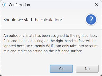

as currently programmed, WUFI cannot take rain, short-wave radiation and long-wave radiation into account on the right-hand side of the component (which is usually the indoor side). So you don't need any special climate file. Just assign your normal climate file to the right-hand component surface and start the calculation. WUFI will display a warning
Forum _ outdoor climate on the right surface.png (19.54 KiB) Viewed 4195 times
and since this is precisely what you want, just acknowledge the warning and proceed with the calculation.
