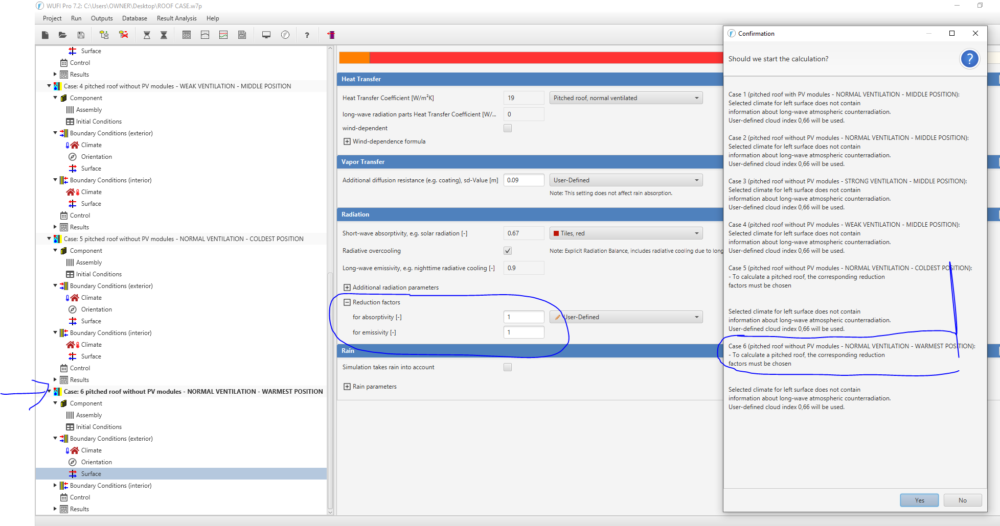

I got a message about parameters that I have defined previously but, the software detects as an error...so my concern is if the results will not be accurate...

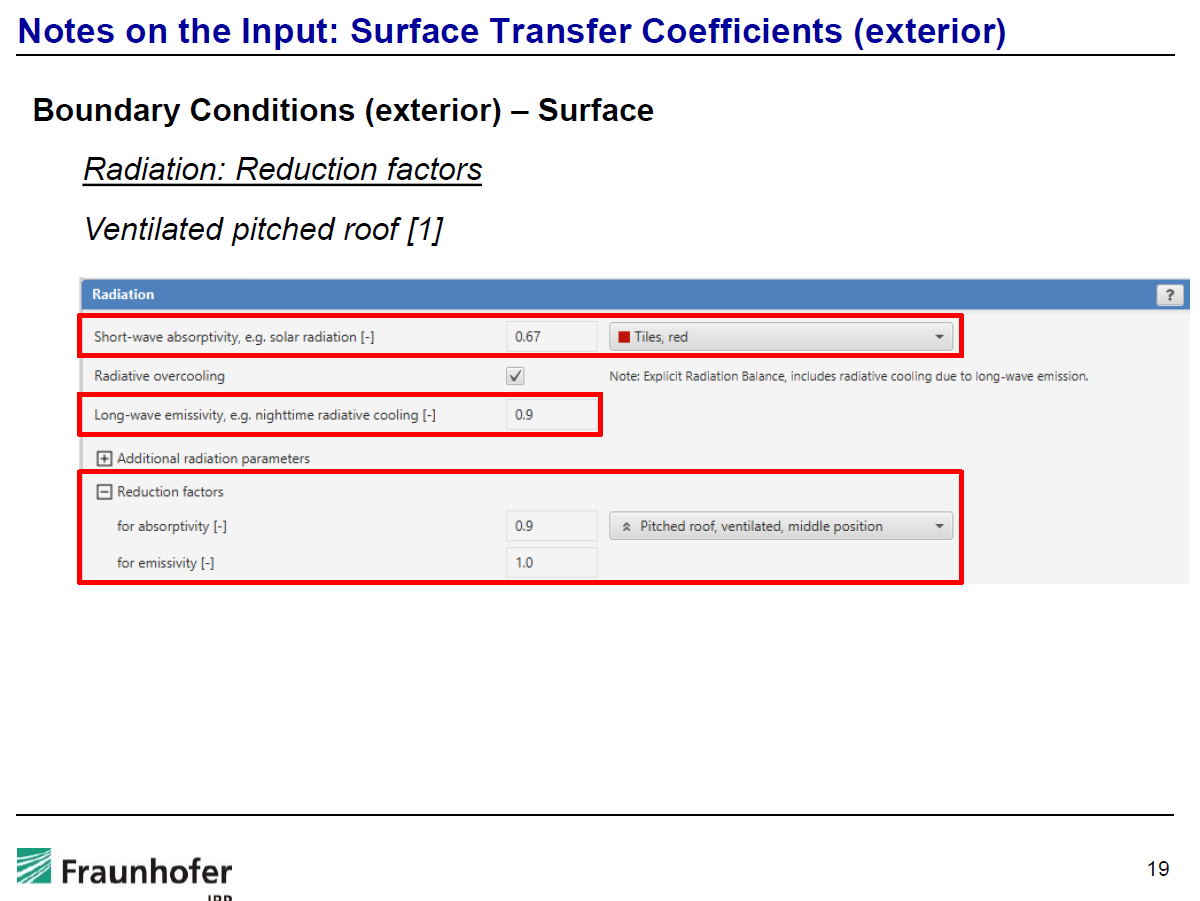

The recommended settings for the reduction factors are illustrated in the Pitched Roof guideline on page 19:
Pitched Roof Settings
pitched roof.png (96.32 KiB) Viewed 5376 times

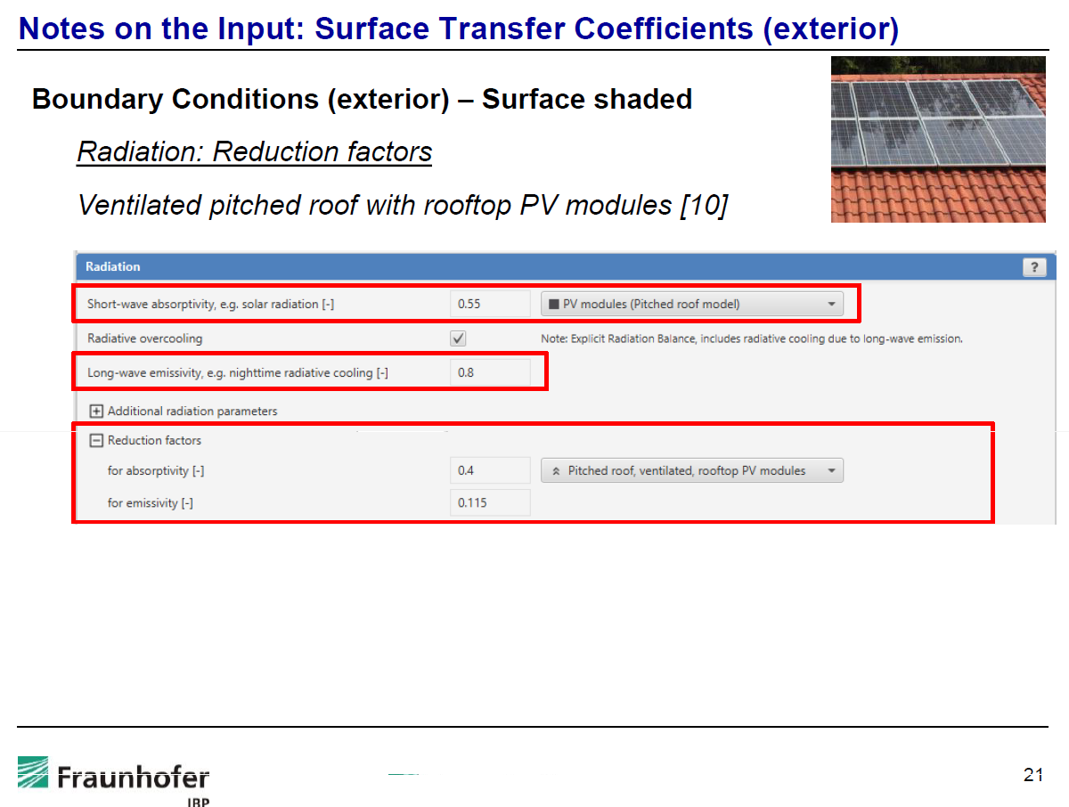

The settings for PV-modules would be on page 21:

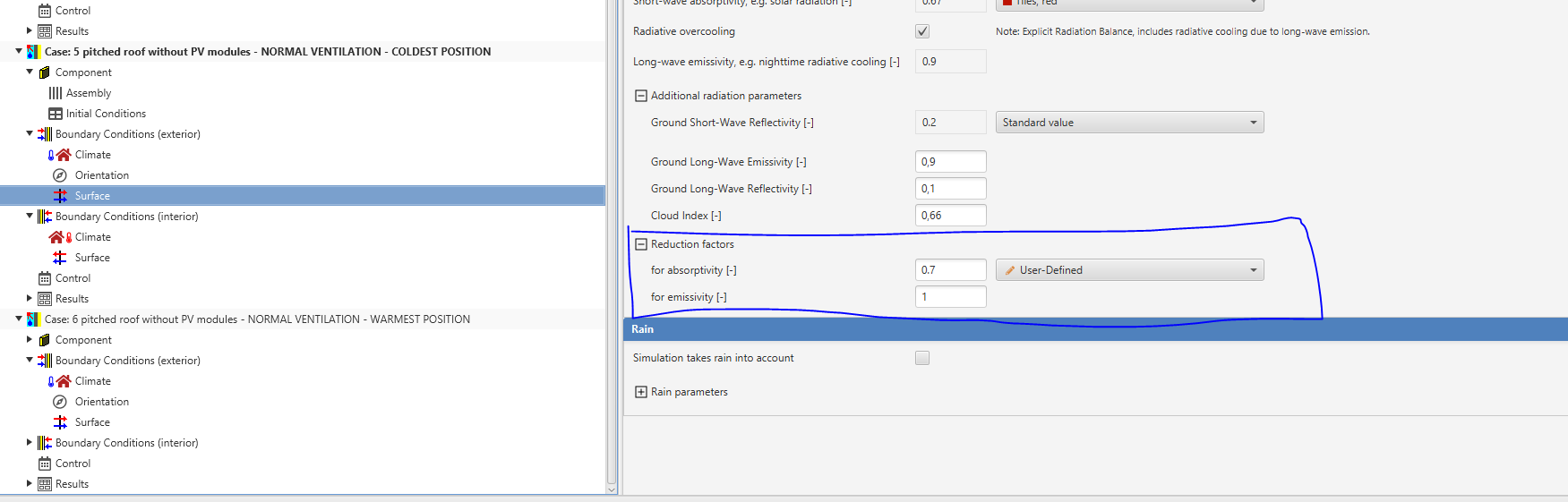

thanks but the error is showed when I define the reduction factor for the coldest and warmest position of a ventilaed roo so, I add user defined reduction factors
Re: Message before simulating + diffence in tendency
it is a warning, not an error.
If you have a specific reason for setting these reduction factors, the warning can generally be ignored.
Only the center position is included in the surface calculation, which is why this warning is displayed. If you are using different positions, you can safely ignore the warning.
