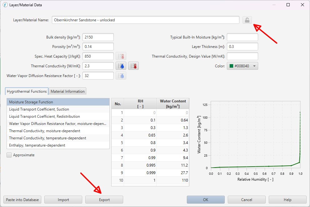

Hi Guillaume,
The manufacturer is most likely referring to an XML file rather than an XLM file.
If the material is already available in a WUFI project, you can export its material data as an XML file:
Open the material in the construction assembly.
Go to Material Properties.
At the bottom of the dialog, you will find the Export as XML function.
Please note that the export function is only available after the material has been unlocked.
The exported XML file can then be shared with the manufacturer for use in their own WUFI studies.
XML Export
XML Export
