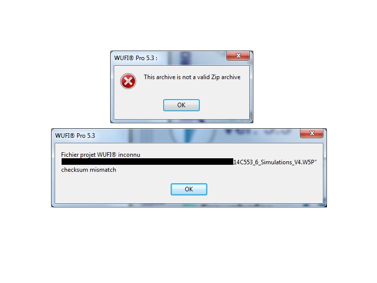

I performed simulations in november with the 5.3 version of wufi. I updated since with the new 5.3 january version.
I try to open the simulation to update them with new hypothesis but I have those 2 windows poping (the 1st one two times and the 2nd one only once).
Any solution?
Cheers,
Problem with old file after updating

Dear Nicolas,
that happens, if there was a problem with storing the file or the files was changed external. There is no possibility to restore that.
That is no update issue.

Hi Christian,
thanks for replying.
I get what a storing problem is (my hard-drive is getting old makes errors for example )
But what do you mean by "files was changed external" ?
- Posts: 1313
Re: Problem with old file after updating
There are some people who want to change the w5p-file using own codes or other software. But if the w5p-file is changed by a third program it shows the same error. But that only happens wanted, not unwanted.
