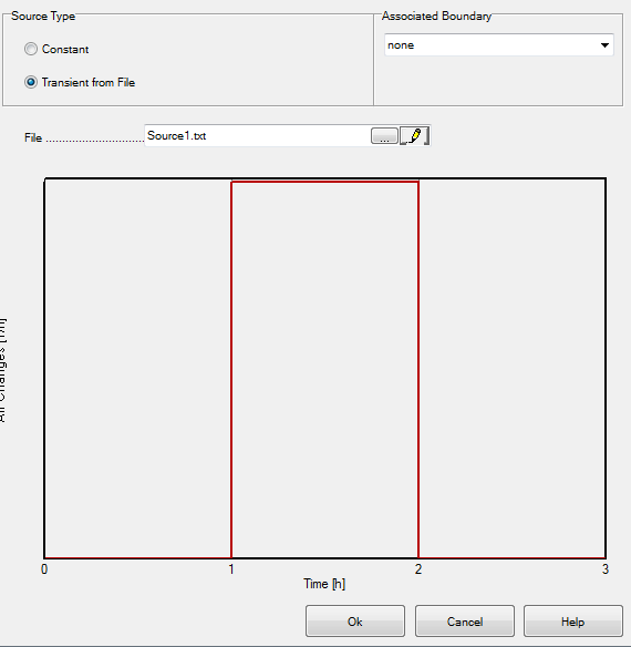

And now I have a question how the Option transient from a file works (in the AirExchangeSource Dialog). After a short time I figured how to create a transient source file (attached file). My question is does WUFI use this source only until it Ends or does it restarts the source file after it Ends.
In short: one run <-> as many runs as possible until the calculation ends?
PS: I don't want to use the air Exchange file posted below. I just wanted to show which Dialog I meant.

Air exchange Source
Air exchange Source
- AirExchangeSource.PNG (11.07 KiB) Viewed 72345 times

The source file starts with the first time step of calcualtion and is circled. So in your case the fourth hour will be the first again.

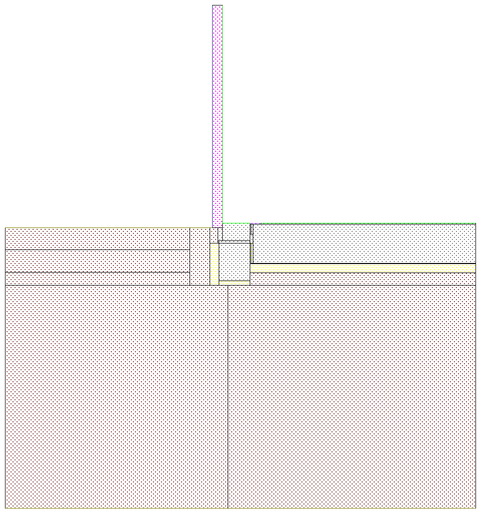

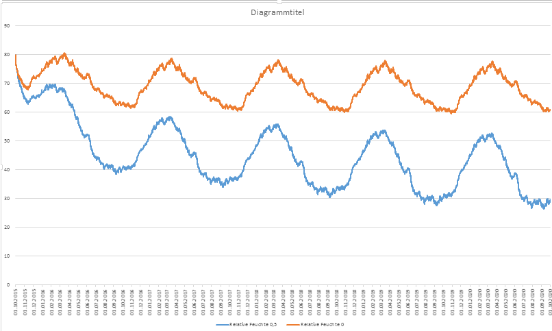

I did a few calculation (see the model below or similar to http://www.wufi-forum.com/viewtopic.php?f=15&t=1190) altering the value of the air exchange source. First from 0,5 1/h on the complete inner surface (which is the upper right rectangle of the model) and than I deleted the sources in the model. So far so good and the results next to the steeldoor were satisfying (see graph below)
In the next step I added the air exchange sources again in the same way as I did for the first calculation. Now putting the values to 0,1 and 0,25 in order to get an understanding which influence the air exchange source has on the results.
Here comes the strange part. The results are all the same as if there were no air exchange source (meaning equal to the orange curve). Even after setting them do 0,5 again, there is no change.

- blue = air exchange source 0,5 1/h
orange = no air exchange source - 1.PNG (21.53 KiB) Viewed 72329 times
