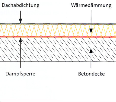

I have a question concerning the air leakage assumption at a flat concrete roof.
At wooden roofs I usually add a moisture source at an apropriate place on the outside of the roof. I use the "air infiltration model IBP" and choose an "air tightne class".
At larger concrete roofs, we have penetrations of the roof and gaps. I guess, there exists air leakages, too.
Would you use the same "air infiltration model IBP" and choose an "air tightne class" as we do it at wooden roofs?
Thanks!

- flat concrete roof
- flachdach gedämmt.jpg (55.05 KiB) Viewed 22837 times

Hello Andreas,
you could use the air infiltration source here, so you have an additional moisture load in your insulation to be on the save side. In reality there probably will be no infiltration through your concrete ceiling.
