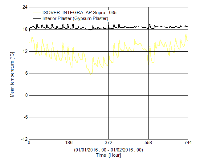

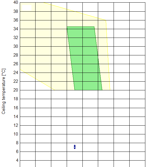

I have simulated an house on Wufi Pro, and the results seem consistent, except for the diagram of the comfort air temperature/ceiling temperature of the ceiling.
Indeed, it displays an inner temperature between 6 and 8°C on this diagram, whereas the layer temperature is always higher than 18°C when i look into the component results.
I have tried several solutions to solve this but it all failed.
Do you have any idea of what could cause this bug?
You will find in attachment my wufi file and a screen shot of the two diagrams i talked about.

- 02. Comfort diagram.png (14.62 KiB) Viewed 11295 times
- 01. Layer temperature.png (17.35 KiB) Viewed 11295 times

Dear NicolasH,
indeed, this is a bug in WUFI Plus. The values for "mean ceiling temperature" are displayed incorrect in the simulation results, as soon as there are two or more ceiling-components in a zone. For one ceiling-component the correct values are displayed. We will fix this bug in a future update. In the meantime I can recommend you as a workaround to calculate the mean ceiling temperature from the interior surface temperatures of your ceiling-components: Retain the calculation results for these components, export the respective columns, calculate the mean temperature (area weighted) with an external software (e.g. MS Excel) and create the diagram there.
For your information: This bug is limited only to the "mean ceiling temperature". The other "mean temperatures" ("mean floor temperature" & "mean surface temperature") display the correct values.
Another note to your attached project: You should carefully rework it, as there are still many inconsistencies. Especially check the normal vectors for each component (see WUFI Plus Manual, p. 27) and the attachements on the inner & outer sides of the components.
